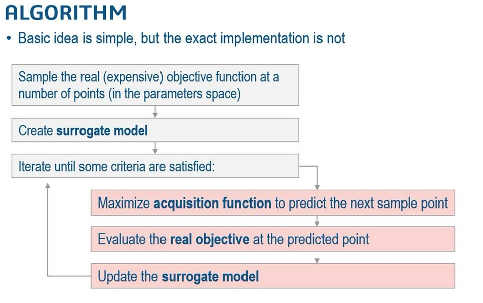

Bayesian optimization is a design parameter improvement and optimization framework intended for very expensive “black box” objective functions (e.g., a time consuming simulation). The main goal is to get the best possible set of design parameters with a “small” number of objective function evaluations. The method relies on (i) creating and using a surrogate model (response surface) for approximating the objective function and (ii) an acquisition function for predicting the next sampling point to be attempted with the expensive objective function. The method requires being able to evaluate an “uncertainty” measure when using the surrogate response model.
In the implementation used by the material calibration kernel, the sampling phase is performed using the Latin hypercube approach based on the number of sample points and the material parameter bounds specified by the user.  (Other global minimizers such as Differential Evolution, Particle Swarm and the Hybrid minimizer start with random sampling.) After the sampling phase, the Bayesian minimization may employ 1-2 “real” objective evaluations per iteration.

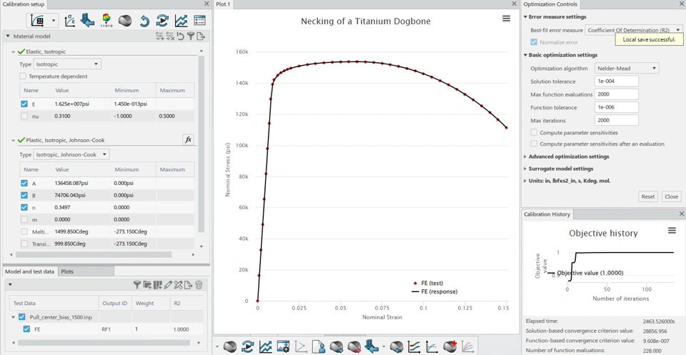

This is a post from 2020 that uses FE mode and the default Nelder-Mead optimizer.  The 1500 C3D8R mesh/model takes ~13 seconds to run on 1cpu on my laptop. This is not terribly expensive, so perhaps this is not a great example to use.  The original setup of this example used nice round numbers in units of psi.  If you open the attached 3dxml file, it should look something like this:    After opening, cache the initial parameter values.
Running it as is, using the default Nelder-Mead optimizer results in a R2=1.00 (to eight decimal places) in about 2464secs ( I am using a development version).  It also recovers the known parameter values quite well.

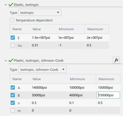

Set the min/max bounds like this:

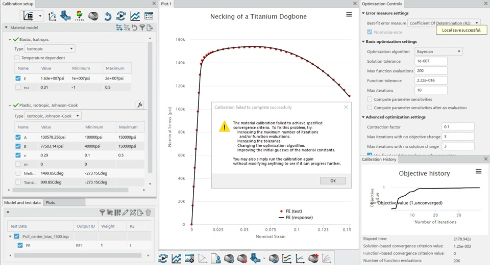

Re-cache the initialized parameter values and run a calibration.  This is how it ends:

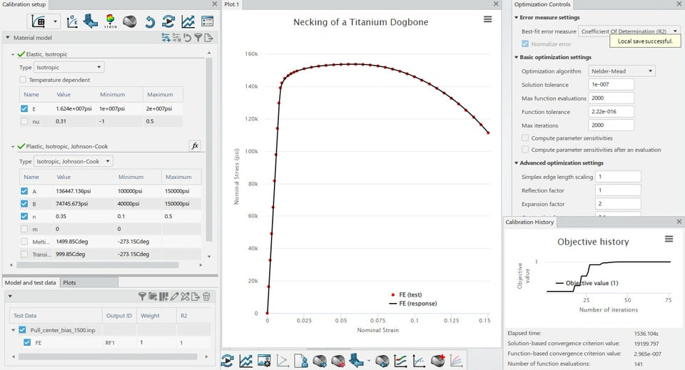

Ok, so try switching to the Nelder-Mead optimizer and click on calibration.
