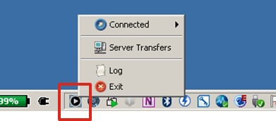

3DX-Connect Desktop Client
The Desktop client is a system tray based menu that contains application modules, with the primary module being “Server Transfers”.  As the name suggests, its primary use is facilitate navigation, creation, and transfer of server content.  The client’s icon appears in the system tray:

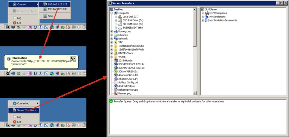

The user connects to the server and launched the Server Transfers module:

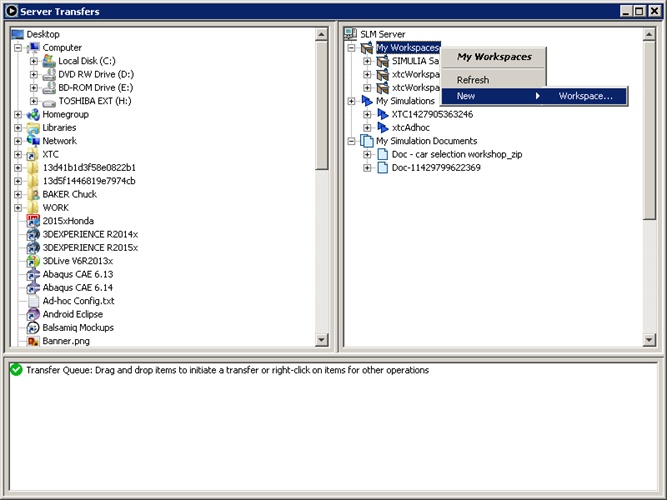

A context-based right-click menu is available to perform actions for either local (left-hand pane) or server (right-hand pane) Content:

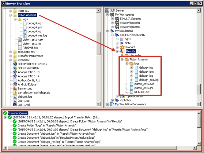

Data (and structure) can be transferred by dragging and dropping items between the local system and server:

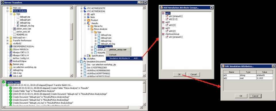

Simulation Attributes may be added or edited for the appropriate server-side content:
