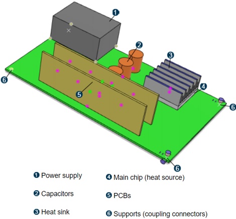

This example guides you through using the Mechanical Scenario Creation app to define and run a structural simulation that examines the response of a printed circuit board to random vibrations. By completing this example, you learn how to:

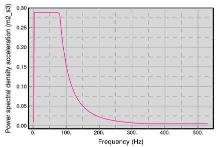

  • Define a random vibration step, including the appropriate frequency and damping parameters.

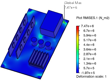

  • Review results from a random vibration simulation (for example, power spectral density plots and root-mean-square von Mises stress plots).
