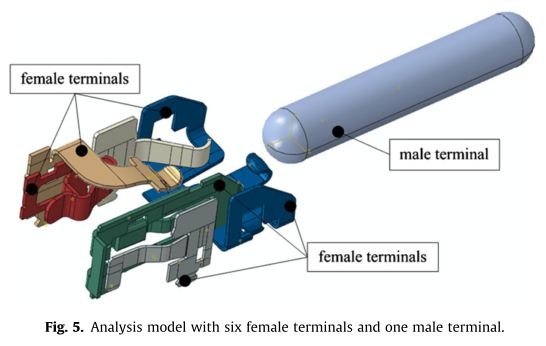

The audio-jack was modeled using five terminals and a rigid male terminal was inserted into the model. The ABAQUS finite element software was used for the numerical calculations. The force was measured during insertion of the male terminal and corresponded with my expectations: the force increased for the first half of the halfway process and then dropped as the rigid terminal clicked into place.

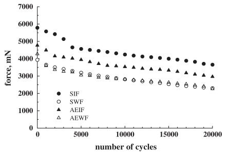

Both the experimental and numerical results demonstrated that the insertion and withdrawal forces declined throughout the tests. The greatest reduction in force occurred during the first 4000 cycles. The model was better at predicting withdrawal forces than input forces which it consistently under predicted.

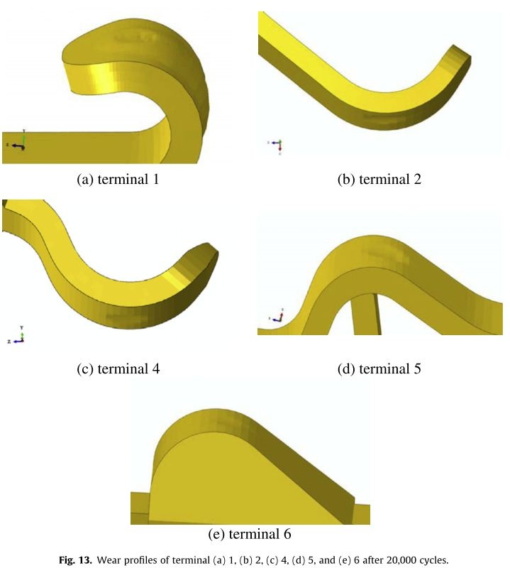

The wear scars calculated are shown in the illustration below. Notice that the wear scar depth is significant with regard to part thickness and dimensions. No wear scar profiles were taken to show a comparison of the shape of wear scars from the field data or experiments with the numerical model. However, this is listed as future work by the authors.
The parts were tested for 20,000 cycles until long past fatigue failure (failure was defined as either the insertion force or withdrawal force going outside of design specifications). In the experimental study and numerical analysis failure occurred at 7,000 and 9,000 cycles respectively. This difference corresponds to differences in strength of about 3%.
