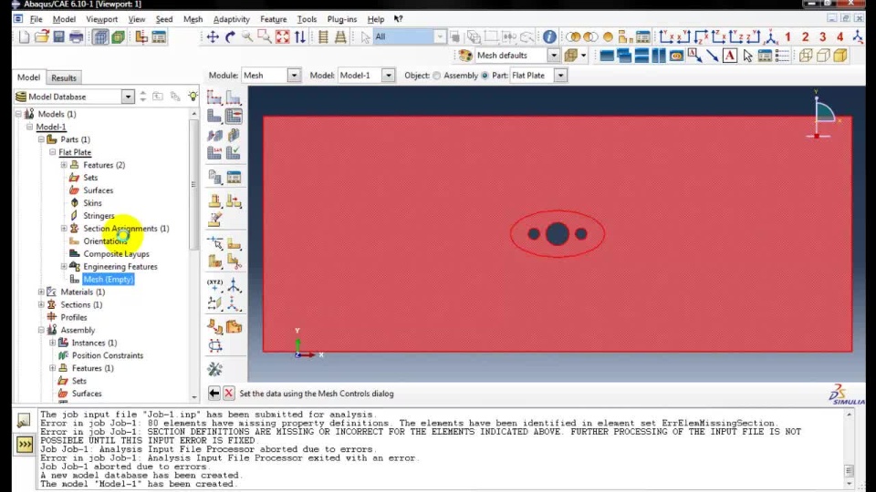

2D Static Stress Analysis of Flat Plate
In this example we will examine the stress concentrations in a flat plate with three holes. This example shown in video, leads you through the Abaqus/CAE modeling process by using the Model Tree and showing you the basic steps used to create and analyze a simple model.
