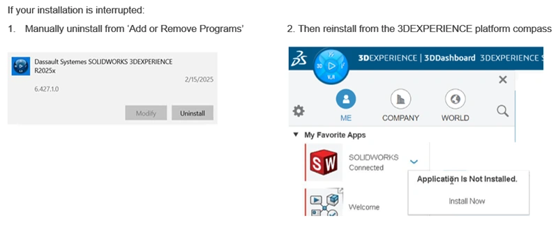

For those who have 3DEXPERIENCE SOLIDWORKS for Makers and are updating SOLIDWORKS Connected to R2025x FD01 version, you may notice that the download speed is faster, and the install time is longer. This is due to a change which improves the overall reliability of the update process and reduces the chance of errors.
Because the installation may take longer than usual (30-60 min), please do not cancel the process once it has started. Interrupting the installation could require additional steps to resolve.
We appreciate your patience as we work to make upgrades more reliable. If you have any questions, please ask in this community. We will be happy to help!
