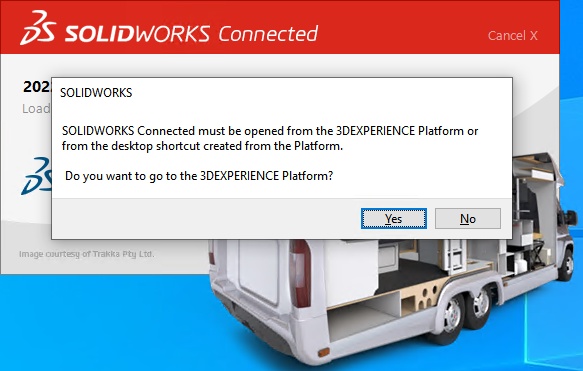

Unless you take one of the above actions, launching SOLIDWORKS Connected in Offline Mode after the R2022x FD04 update will display the message: “SOLIDWORKS Connected must be opened from the 3DEXPERIENCE Platform or from the desktop shortcut created from the Platform. Do you want to go to the 3DEXPERIENCE Platform?”
