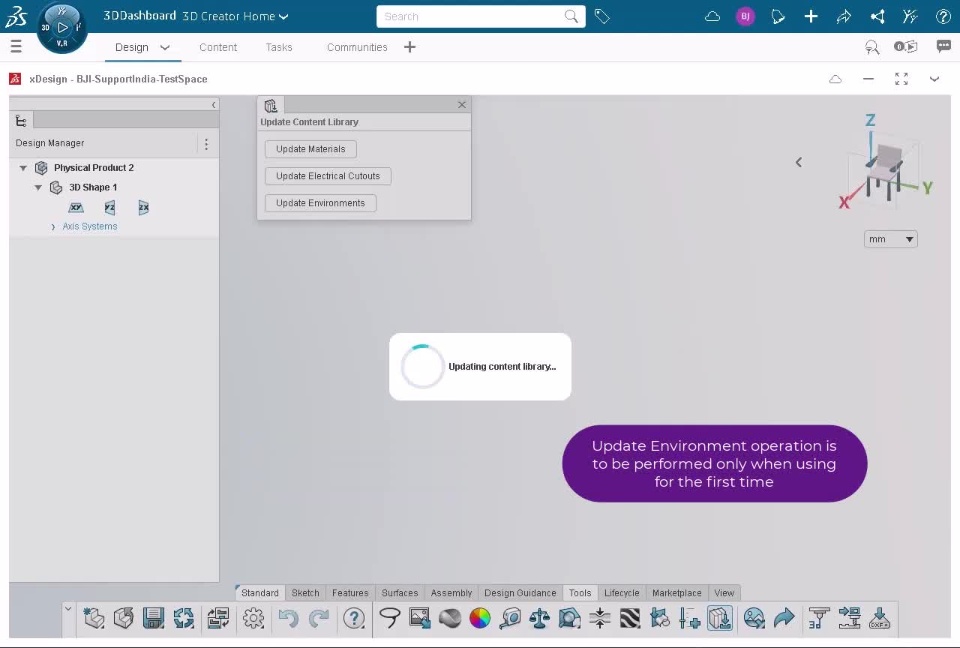

Steps to setting up your Environments:
- Create a new physical product > click Save
- Navigate to Tools > Update Content Library > Update Environments. The update process duration may vary based on your internet speed.
- Once the update is complete, click Insert Environment to get started.
The above steps are also indicated in the video below:

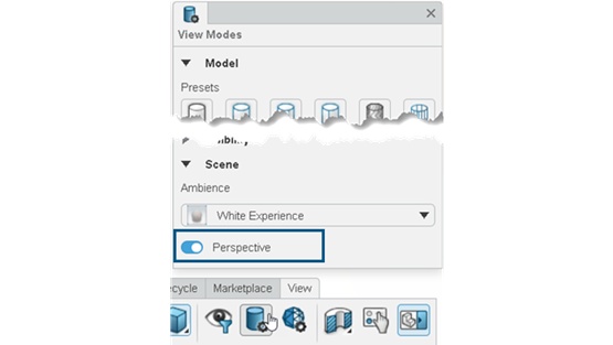

A quick heads up:
- Upon inserting the environment, the view mode will switch to perspective. You can modify these settings from View in the toolbar> View Modes.
