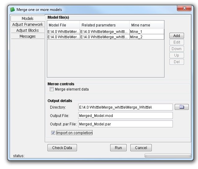

• Invoke the function from Tools > Merge Models
 Select the required *MOD and *PAR files and fill the required field

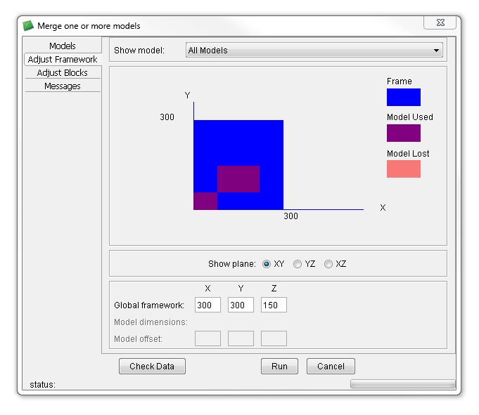

Select the “adjust frame work tab” to make sure that there is no “Model Lost”
 Check the box “Import on completion”, it is also possible to import the files later using Import options in Whittle

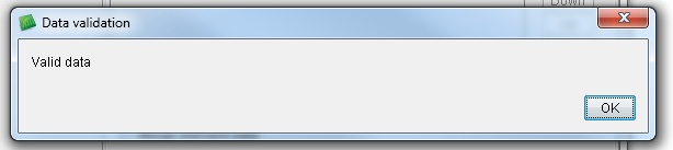

Use “Check Data” box to make sure that data is valid

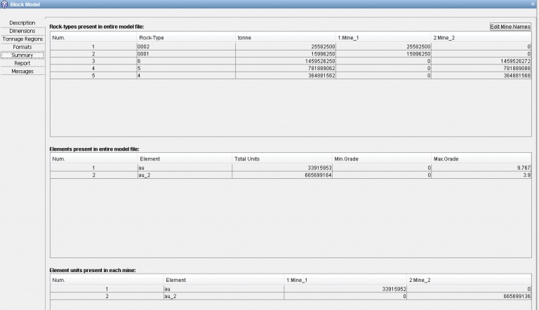

After the completion of import, both block models will be merged in to single block model and the optimization workflow can be imitated.
 Do not forget to validate the numbers against the original block models before running optimisation and scheduling.

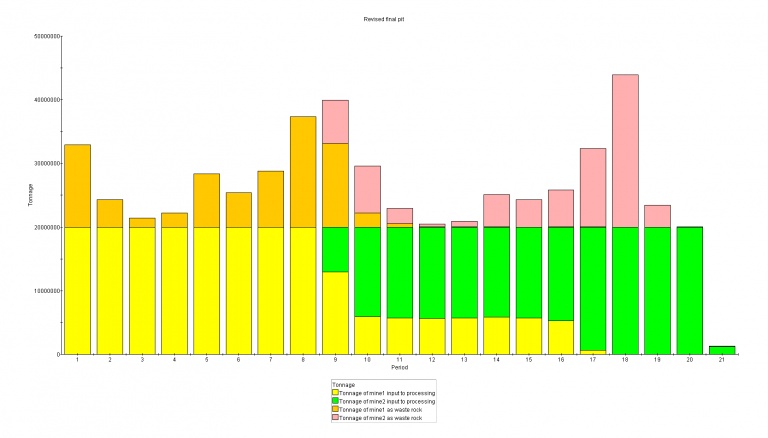

You can use Whittle LOM scheduling tools to create strategic schedule using one of available scheduling algorithms
