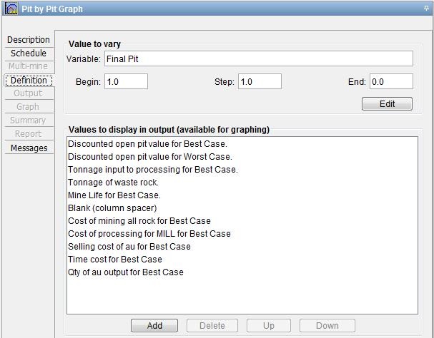

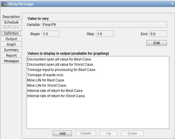

Each graph has a Definition tab with a default set of outputs to be reported. However, users often customize the Definition tab to report other items. For example, below is the default Definition of a Pit by Pit Graph:
A customized Definition may include other items such as all the costs as well as metal produced, in order to calculate the all-in sustaining cost per ounce of gold for each pit.

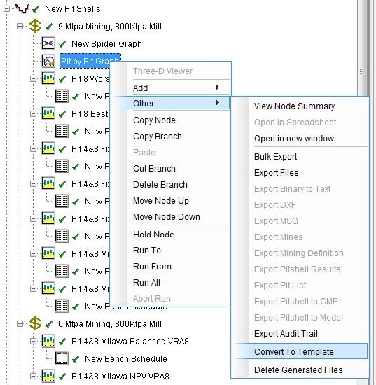

To save the customized Definition as a template, right click on the Pit by Pit Graph > Other > Convert to Template:

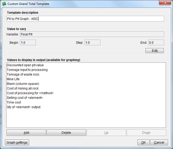

Name the graph under the Template description. In this example I have named it Pit by Pit Graph – AISC.

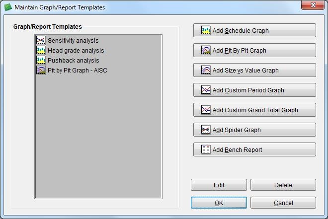

It will appear under the list of templates already created:

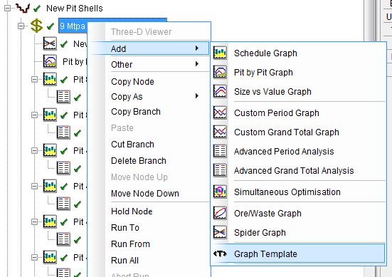

To retrieve the saved template, right click on the Scenario node > Add > Graph Template, then select the template from the list.
