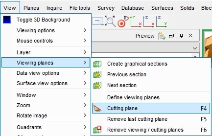

The visual cutting planes functions can be found in the menu under View >Viewing planes >Cutting plane.

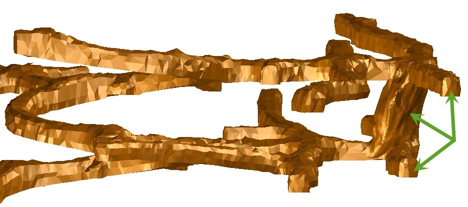

In the example below, I want to hide most of the upper and lower development so I can just see a couple of headings and the stope.
Because I still want to see a portion of the development headings, I can’t just use the visibility controls and make layers invisible.

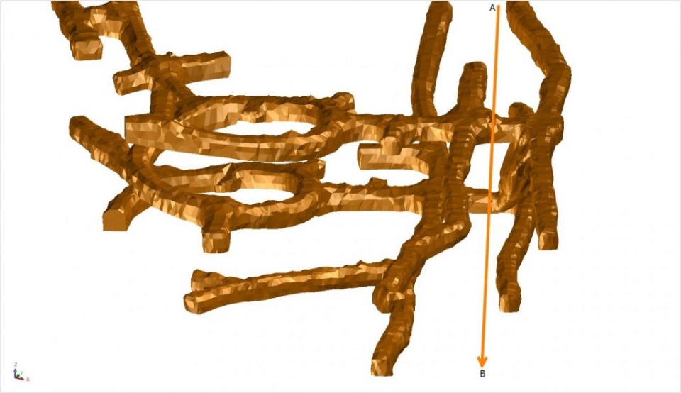

The way to use visual cutting planes is to first orientate your data in graphics so that it can be cut where you require. In the diagram below, I have rotated the data so I can cut it. The line A-B indicates the direction of the cut.
NOTE: The direction is important as everything on the right hand side of line A-B will be hidden.
Invoke the function View > Viewing planes > Cutting plane and follow the instructions displayed in the status bar. You can also use the shortcut CUT to invoke the function.

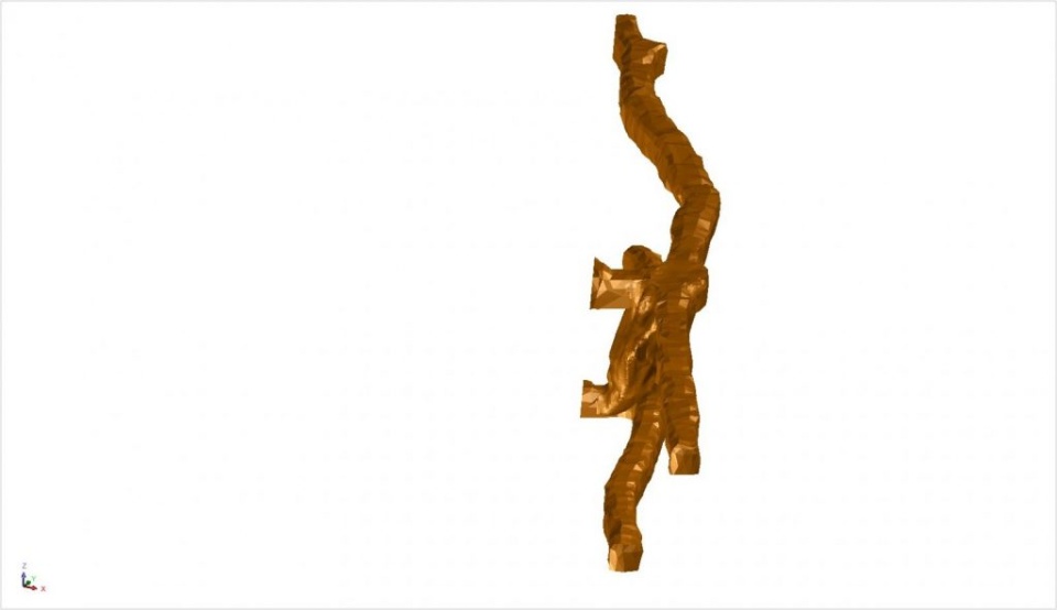

The function stays active, meaning you can cut your data as many times as required. Press Escape to finish.
Made a mistake? Don’t worry, just use the function View > Viewing planes > Remove last cutting plane to undo the last cut.
The below diagram shows the cut data rotated.

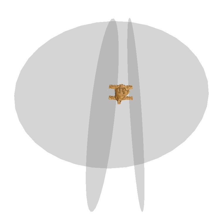

By default, Surpac will show a grey disc around each cutting plane.
If you want to hide the discs, use Customize > Default preferences as shown below
Unchecking the box will not remove any existing visual cutting planes, but only applies anything done AFTER the box has been unchecked.
