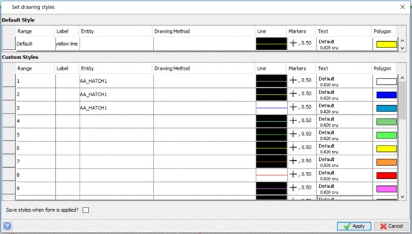

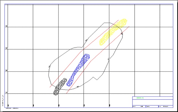

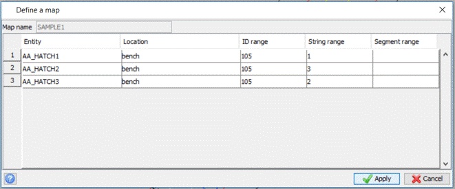

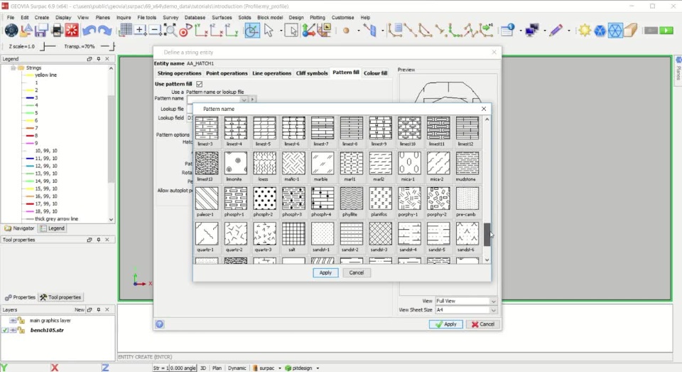

Plotting Tip & Trick #6: PLOT HATCHING
Solution: Create an entity for hatching
Solution:
For Autoplot: Go to Set drawing styles form (SSTR), nominate this entity on the Entity column of the desired strings to be hatched. Plot using Autoplot.
For File-based plotting:
Go to Plotting -> Map -> New, input the name of the map, then nominate the entity, source file, and strings to be hatched.
SAMPLE PLOTS IN SCALE:

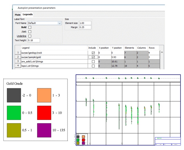

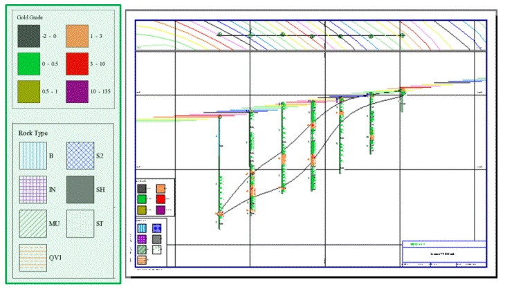

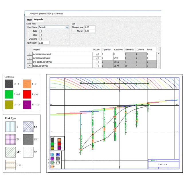

Plotting Tip & Trick #7: LEGENDS ★ ★ ★
Having a hard time creating legends and tables on plot files?
MAP LEGEND
Solution:
For Legends:
• Upon plotting using Autoplot, go to Legends tab.
• On the Include row, mark the Legends to be incorporated.
• Click Apply.
For Tables:
• Click Apply.

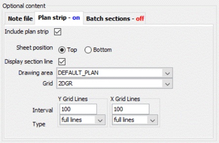

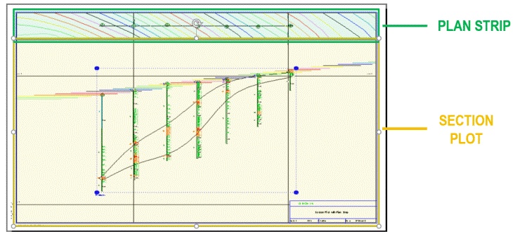

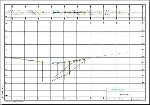

Plotting Tip & Trick #8: SECTION W/ PLAN STRIP
Plotting section maps with plan strip on the same sheet?
• Open Surpac, load the necessary files (e.g. drill hole database, strings, DTMS, etc.)
• Go to Plotting -> Autoplot
• Under Optional Content -> Plan Strip
> Check ‘Include Plan Strip’, then fill necessary details
SAMPLE SECTION PLOT WITH PLAN STRIP:

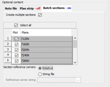

Plotting Tip & Trick #9: BATCH PLOTTING
Solution:
• Under Optional Content -> Batch sections
> Check ‘Create multiple sections’, then select desired sections to be plotted.
Note you can also have both plan strip and batch section at the same time.
BATCH PLOTTING OUTPUT:

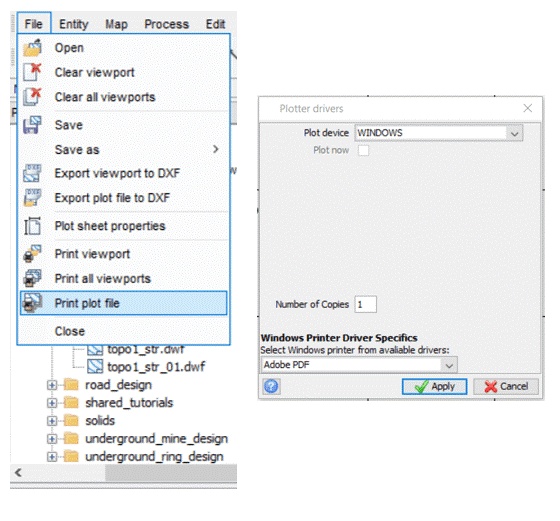

Plotting Tip & Trick #10: SAVE MAPS IN PDF
Having the need to save maps in Portable Document Format or PDF? Here’s the trick.
Solution:
• Make sure the machine has a PDF software.
• Open Surpac, go to Plotting -> Plotting window
• On Plotting window, go to File -> Print plot file, then select the plot file
• Select WINDOWS as Plot device
• Select the ‘PDF software’ as the windows printer driver. Click Apply.
