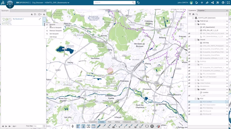

How to access the bookmark panel:
How it works
Here is a video illustrating the creation of bookmarks with the appropriate data and points of view on an urban development project.

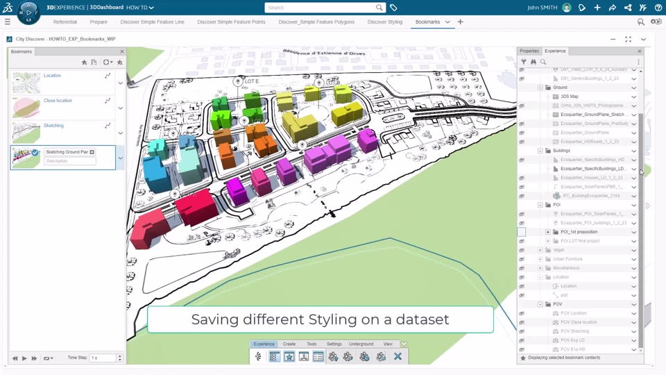

In order to save a bookmark, determine the point of view as well as the data to display, then create the bookmark using the dedicated button.
Persistence of styling on the same dataset
This video shows the persistence of styling in the bookmark panel on the same dataset.
A manual process, but allowing a multitude of data to be scripted
