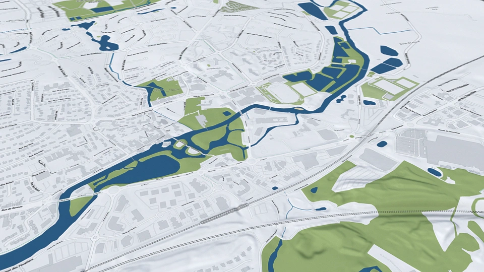

Did you know that you can start your virtual twin experience with an out-of-the-box map?
For each new created referential, user can add a 3DSMap (based on OpenStreetMap) that offers map tiles with detail down to the building footprint level.

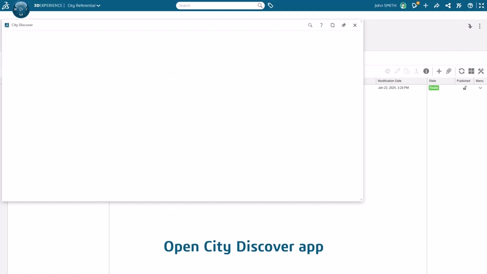

Prerequisite
Create and name your referential (i.e. select a EPSG code, indicate bounding box area with Xmin, Xmax, Ymin, Ymax)
Create your 3DSMap
Select “+” and choose 3DSMap.
A 2D map covering the entire referential area will be automatically created.
Wait for its status to turns be Ready and then add it to your experience.
