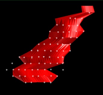

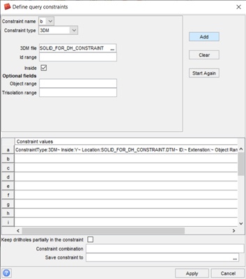

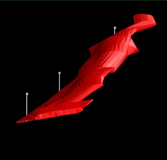

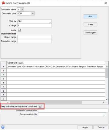

3DM constraints

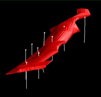

  • If you are wanting to see the drillholes that are within a solid
  • Database>display>add new constraint
  •  Select the 3dm option in the constraint type, select the solid and apply.
  • Hide the faces of the solid and display the edges so you can see the drillholes within the solid.

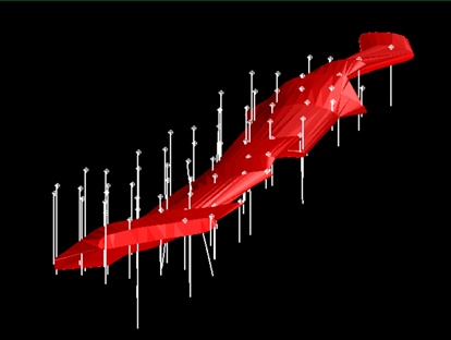

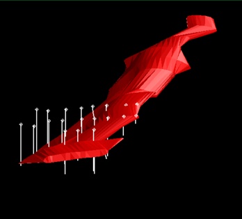

  • If you want to see all the holes that intersect a solid, then you would use the option “drillholes partially in the constraint.”

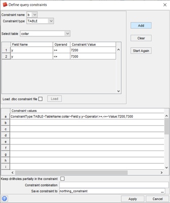

Table constraints
  • You can create a table constraint based on northing

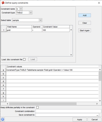

  • If doing a constraint on an interval table, then select the table and the field. Eg you may want to see the holes with Gold>100
  • You can now also use a wild card ‘*’ to filter out the holes you want to display.

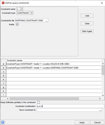

  • Constraint files
    • You can use existing .dbc files but REMEMBER these were only applied to a table.
    • You can use the new xdbc format.
  • Combinations
    • You can use the combination ‘or’
  • You can use the combination ‘and’. NOTE: the constraints are 'and' by default.

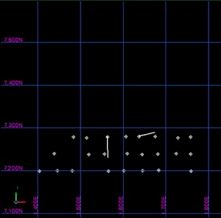

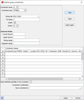

String Constraint
  • You can now constrain the drillholes graphically by using a closed polygon
