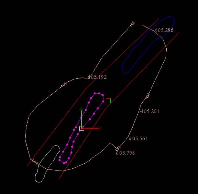

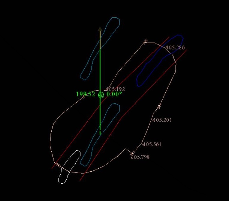

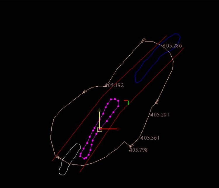

The data-centric mode is the most efficient way to perform most graphical operations. To move data along an axis, select the data first, hover the cursor to one of the axes (X, Y, or Z) and then click and drag. To copy the data along an axis, hold the CTRL key and then perform similar steps to moving data along an axis.
Selection of data to be moved or copied
Hovering of cursor to one of the axes (note: axis turns yellow when hovered.)
Clicking and dragging of data to desired location

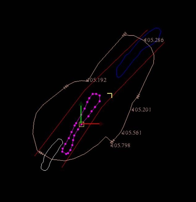

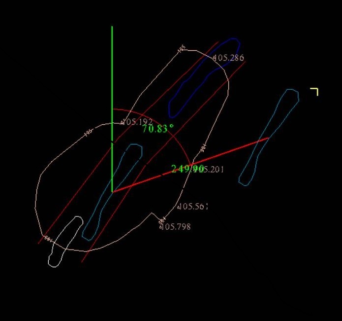

To move data in an orthogonal plane, select the data, hover one of the plane corner markers (XY, YZ, or XZ), and then click and drag.
To copy the data in an orthogonal plane, hold the CTRL key down and then perform the similar step to moving data in an orthogonal plane.
Hovering the plane corner marker (note: plane corner marker turns yellow when hovered.)

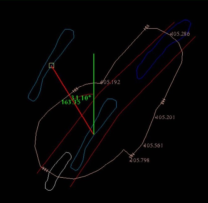

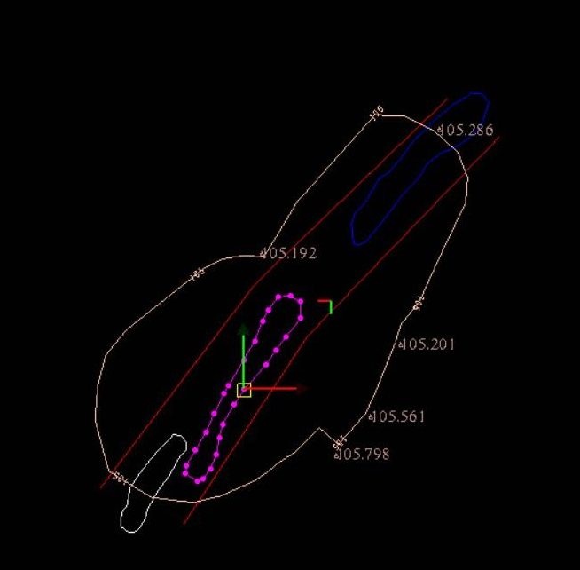

To move data in the current plane, select the data, hover the cursor within the square at the origin of the axes (X, Y, or Z), and then click and drag. To copy data in the current plane, hold the CTRL key down and perform similar step to moving data in an orthogonal plane.
Hover the yellow square at the origin of axes
Clicking and dragging of data to the desired location
