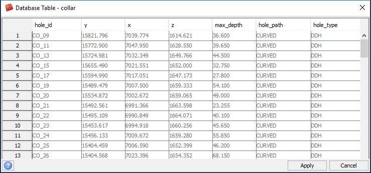

Before using the drillhole constraint tools, it is recommended the user should first ensure an optional field exists in the collar table (not mandatory). This field will serve as a flag, to select holes of different types, categories or areas (e.g. Hole Type, Year Drilled etc.). For example, below this Collar table has the optional field ‘hole_type’, which can be used with drillhole constraints to select only the ‘DDH’ holes.

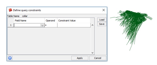

1) If left blank all holes in the database will be selected.

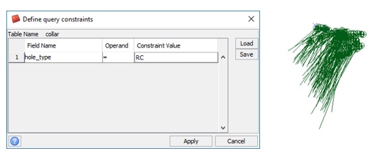

2) Select holes by a flag field (e.g. Hole Type) in collar table. For example, to only select RC holes in the database.
Note: Using the Save and Load buttons a *.dbc file (drillhole constraint file) can be saved and re-loaded. This feature is particularly useful if the desired constraint is complex and made of many rows, as the user wouldn’t want to manually re-add rows and redefine the constraints each time the constraint is required.

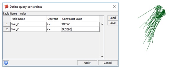

3) Select holes based on a range of hole ID’s. For example, only the select holes between JRC060 and JRC090.
Note: The operand symbols in the above form (e.g. >=), will also work with alpha characters.

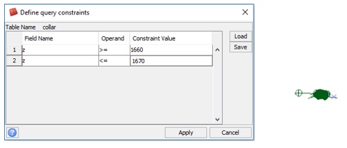

4) Select holes based on elevation. For example, only the select holes by collar elevations within a range (e.g. in a bench).
