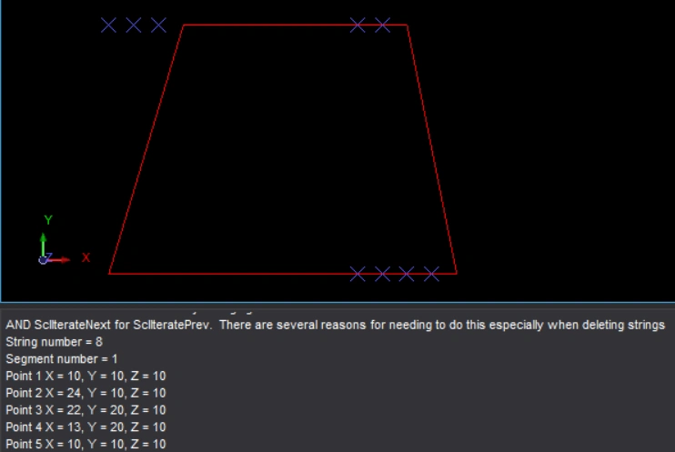

puts "You can also iterate backwards by changing SclIterateFirst for SclIterateLast"
puts "AND SclIterateNext for SclIteratePrev.  There are several reasons for needing to do this especially when deleting strings"

Here are some other things that can be done with this simple looping code.
  1. Write points to a csv file
  2. Modify the z value of points in a segment
  3. Write points inside a boundary to a new layer
  4. Identify points by inquiring their dfields.
\\\$StrsH SclIterateLast StringsIterator
while {[\\\$StringsIterator SclIteratePrev StringHandle] == \\\$SCL_TRUE} {
  puts "String number = [\\\$StringHandle SclGetId]"
  \\\$StringHandle SclIterateLast StringIterator
  while {[\\\$StringIterator SclIteratePrev SegmentHandle] ==  \\\$SCL_TRUE} {
    puts "Segment number = [expr [\\\$SegmentHandle SclGetId]+1]"
    \\\$SegmentHandle SclIterateLast SegmentIterator
    set PointCount 1
    while {[\\\$SegmentIterator SclIteratePrev PointHandle] == \\\$SCL_TRUE} {
      set x [\\\$PointHandle SclGetValueByName x]
      set y [\\\$PointHandle SclGetValueByName y]
      set z [\\\$PointHandle SclGetValueByName z]
      puts "Point \\\$PointCount X = \\\$x, Y = \\\$y, Z = \\\$z"
      incr PointCount
