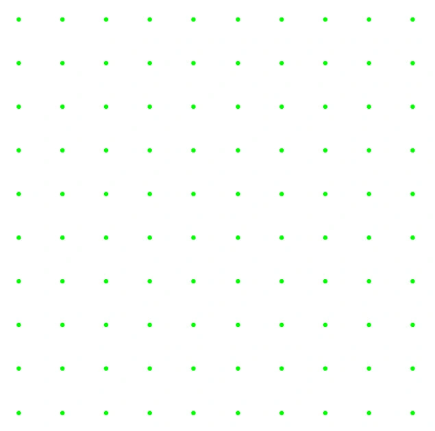

  • The final result will be output to the graphics window and should look similar to below.

We used a nested for loop in part 9 to create 100 points of data in a grid.  I'll show how that is done again by adding the code below.
<i><strong>#This is the nested for loop from part 9 as a reminder of how we put data into the array.</strong></i>
<i><strong>#Lets use nested for loops to put 100 points (x,y) into an array.  The string number and z values will be constants that we will add later</strong></i>
<i><strong># This is the point count that we'll use as array key.</strong></i>
set i 1
<i><strong># This for loop will increment the x coord</strong></i>
for {set x 1} {\\\$x <= 10} {incr x} {
  <i><strong># This for loop will increment the y coord</strong></i>
  for {set y 1} {\\\$y <= 10} {incr y} {
    set pointX(\\\$i) \\\$x
    set pointY(\\\$i) \\\$y
    <i><strong># Setting z value to a constant 10</strong></i>
    set pointZ(\\\$i) 10
    puts "Point \\\$i coords are -> \\(\\\$x,\\\$y\\)"
    <i><strong># Incrementing the key number</strong></i>
    incr i
<i><strong>#Check to see how many points have been added into the array</strong></i>
set arraySizeCheck [array size pointX]
puts "There are \\\$arraySizeCheck points in the array"
Now the information has been added into an array, let's retrieve it and draw the points to the screen.
<i><strong># We will now use a for loop to retrieve information from an array.</strong></i>
for {set j 1} {\\\$j <= \\\$arraySizeCheck} {incr j} {
  set newX \\\$pointX(\\\$j)
  set newY \\\$pointY(\\\$j)
  set newZ \\\$pointZ(\\\$j)
  <i><strong># Run the newPoint procedure to create points from the array</strong></i>
  newPoint \\\$arraySeg \\\$newX \\\$newY \\\$newZ
\\\$arraySeg SclDraw

##### Part 10 #####
puts ""
puts "Part 10 - Retrieving information from an array"
# This part of the series flows on from "Part 9 - Using Arrays to store information"
# See part 2 for how a procedure works.
proc newPoint {segHandle x y z} {
  \\\$segHandle SclCreatePoint pntHandle [\\\$segHandle SclCountItems]
  \\\$pntHandle SclSetValueByName X \\\$x
  \\\$pntHandle SclSetValueByName Y \\\$y
  \\\$pntHandle SclSetValueByName Z \\\$z
  return \\\$pntHandle
# Get a reference to the active viewport (You can have more than one) store it in reference variable "vh"
SclGetActiveViewport vh
# Create a layer called array that can be manipulated/inquired with the "arraySwa" reference variable
SclCreateSwa arraySwa "array"
# Add the array layer into the layers pane so it is visible
sclGraphicsLayers SclAdd \\\$arraySwa \\\$vh
# Set the "array" layer to be active
\\\$vh SclSetActiveLayer \\\$arraySwa
# Using the reference to "arraySwa", create a reference variable "arrayStr" and make the string number 1
\\\$arraySwa SclCreateString arrayStr 1
# See details from part 1 about how this works.
\\\$arrayStr SclCreateSegment arraySeg [\\\$arrayStr SclCountItems]
set i 1
    incr i
\\\$arraySeg SclDraw "style=ssi_method=marker,HGS_color=marker=green"
SclFunction "ZOOM ALL" {}
puts ""
puts "This ends our 10 part series on using some TCL/SCL commands in Surpac.  See you in 2025 for some creative coding!"
