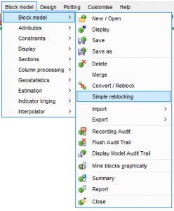

3. Go to Block Model > Block Model > Simple Reblock

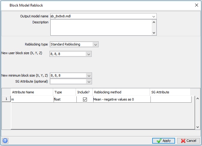

4. In the form above:
• Enter your output block model name and the description (description optional).
• Select the type of reblocking, Standard or Advanced (Standard for regular blocking, advanced for variable blocking). Advanced Reblocking gives you much more flexibility, but will be much slower than Standard Reblocking.
• Define the new user and sub-block sizes.
• Choose which attributes will be included and their reblocking method. See details on each reblocking method by pressing on the ? icon to access Surpac help.
• Select an SG attribute, if desired. The SG attribute controls the weighting, if left blank by default weighting is performed by volume, whereas if an SG attribute is selected then weighting is performed by tonnage.
Click Apply to reblock the model.

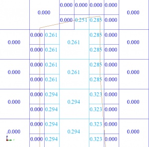

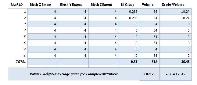

Input BM: User block size: 4x4x4

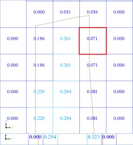

Output BM: User block size: 8x8x8

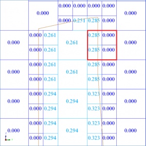

Grade assigned to reblocked model applied a volume weighted average. For example, for the selected block above:
The same result can also be seen on the sub-blocked input block model:
Input BM:

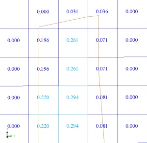

Sub block size: 4x4x4
Output BM: User block size: 8x8x8​​​​​​​
