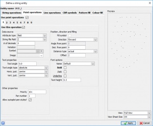

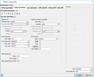

To display the RL value & symbol against each of the grid points, create an entity using Plotting > Entity > New and go to point properties as per the respective images below:

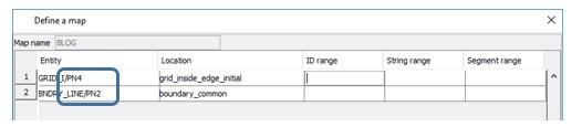

After obtaining the entity, go to Plotting > Map > New; browse respective string files against each entity:

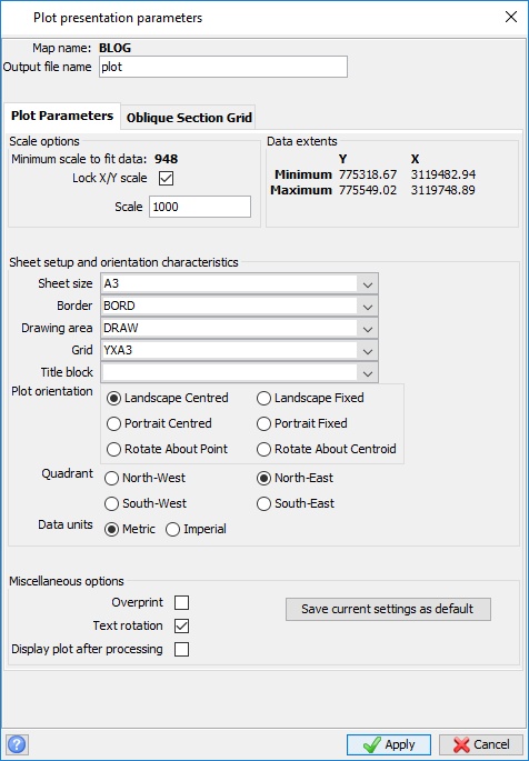

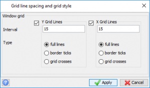

Choose sheet size, scale, grid properties (in this example grid spacing is 15×15), etc. as per your own requirements.

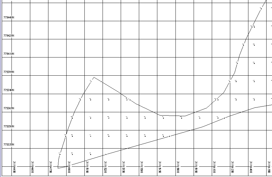

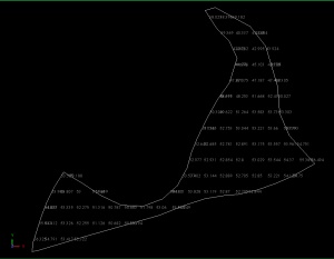

It will generate a DWF file and open the DWF file into Surpac Plotting window:
As you can see, the grid lines don’t currently reside over the grid points, but as i want actual grid lines over my grid point; I need to apply some grid offset for X & Y grid lines.

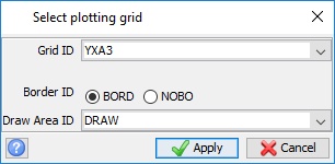

Go to Plotting > Plotting sheet setup window; a new plotting window will appear. Go to Grids > Select and chose Grid ID, Border ID & Draw Area ID, you have selected earlier:

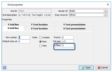

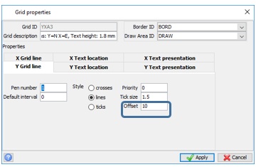

As per the initial plot file, it seems that we need to shift the X & Y grid line by offset amount 5 & 10 respectively. Go to Grids > Properties as per the image below, and then go to Grids > Save:
