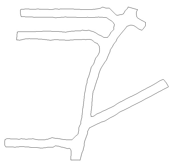

We will be using the following example of a pickup on 12 level.

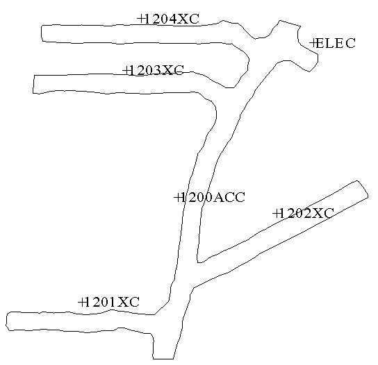

Normally, you would have one string number dedicated to displaying text. Let’s say our text string was 99 and all text is contained in the d1 field of string 99.
Displaying the markers (PM) and the d1 field (PD) of string 99 would show the following in the graphics:
As you can see from the above example, all text is at a 90 degree bearing. This is because you can only have one text orientation per string number in Surpac.

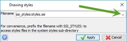

3. Click on the drop down box.

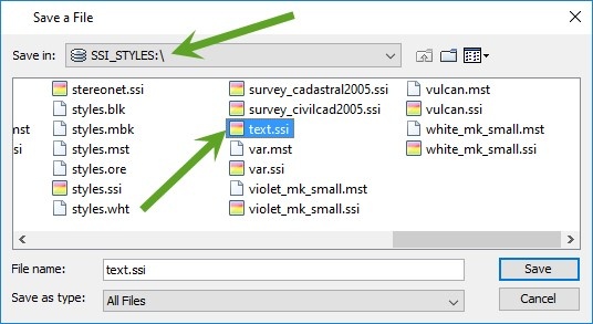

4. Select the SSI_STYLES (logical if you have followed Step 1. Otherwise navigate to where you copied text.ssi).
5. Choose text.ssi from the list of .ssi files.

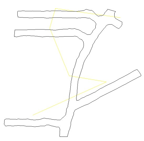

6. Your text layer may now look like below. This is due to the fact that string 99 is not listed in the text.ssi file and is therefore displayed by default as a yellow line.
7. Convert all the points on this string to single point segments. This can be done in Surpac 6.8 onwards using the function Edit > String > Explode.
You should now be able to see points on the screen instead of a single segment.

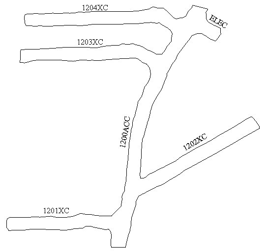

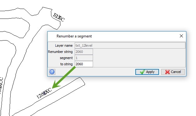

10. I can now run Edit > Segment > Renumber and change each point to a different string number for orientation. Note that you may need to display markers (PM) to enable selection of the points
11. The final result is as below.

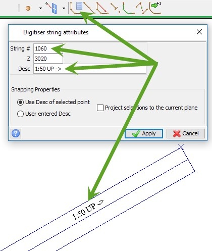

This type of text also works great for Development Engineers when specifying a gradient for a new heading. As the text is already orientated, confusion is eliminated and there is no need to annotate the final plot with this information.
