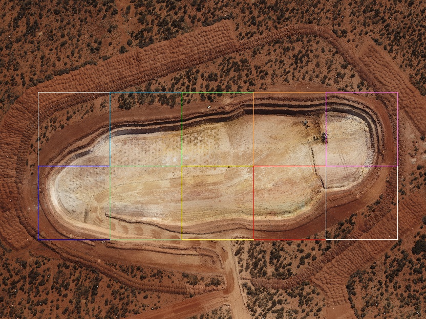

With this in mind, I have created a workflow which meshes point clouds much faster. All that is required is a small amount of prep work to create a series of polygons that cover the area you want to mesh. (We have macros to assist if required.)
Point cloud with overlaid polygons

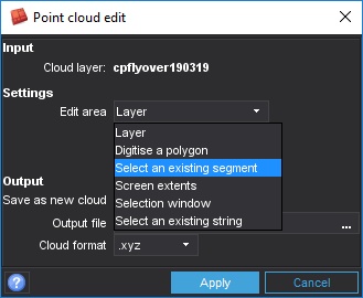

Step 1. Clip the point cloud to leave only the area to be meshed.
  • If this is possible, it is always recommended. There is no point meshing areas that aren’t going to be used in downstream processing.
  • Use Surfaces -> Mesh Tools -> Point cloud edit to clip the point cloud by an existing boundary if you have one. Otherwise select the option to “digitize a polygon”

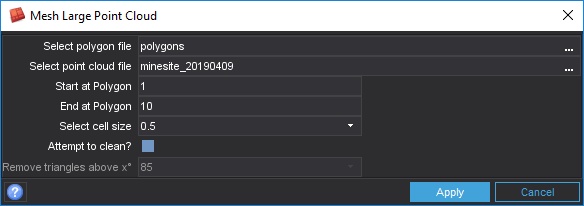

  • Run 1_quick_mesh.tcl and select your polygon file as well as your point cloud file. Use the .dspc format if possible otherwise .xyz or .asc will work fine.
  • Enter the start polygon number and the end polygon number for meshing (All polygons in between must exist)
  • Enter the cell size. The smaller the cell size, the longer it will take to process, so choose a size that is fit for purpose.
  • Attempt to clean. Use this option if you want to remove triangles that exceed a certain dip angle. (Off by default)
    This can be an effective way of cleaning rogue points in a cloud, however most cleaning of point clouds requires an iterative approach and should be looked at beforehand.
NOTE: Running this macro will create a new folder in your current work directory called “pc_results” This is where all of the separate point cloud meshes will be saved when 1_quick_mesh.tcl is run. Also note, if you have chosen the “Attempt to clean” option, some of the meshes may not have triangles in the dtm file. This is normal and is sorted when running the next macro.
