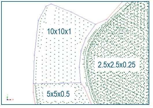

To help manage this within a single block model where different domains are drilled with different patterns, GEOVIA has introduced the variable sub-celling feature into Surpac 6.7.2. This allows a block attribute to be estimated into different domains, using different block sizes in each, within the same block model, thus ensuring appropriate sample support for each domain.
Example of domains with differing sample distribution

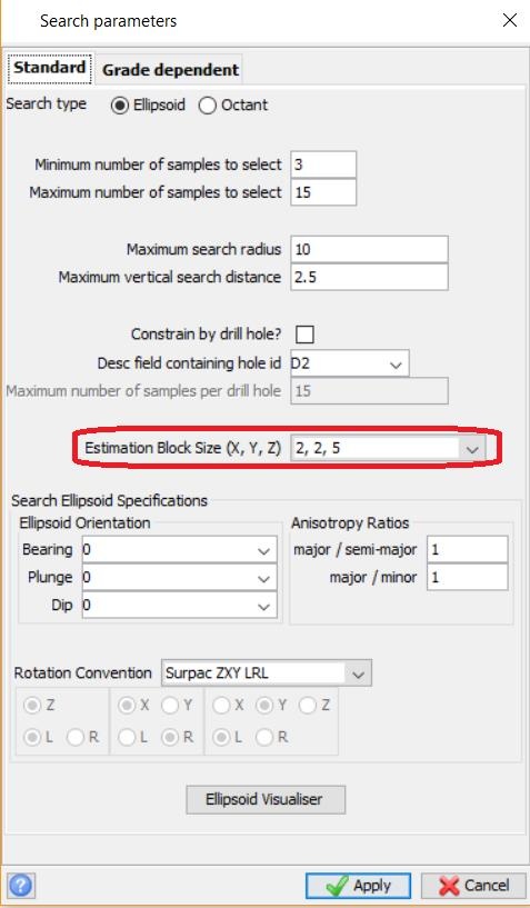

In the first form, select an input string file and the relevant d-field(s).
Then within the ‘Search parameters’ form, to apply variable sub-celling, select a block size in the drop down box that differs from the user block size (highlighted in red below)
Search Parameters form

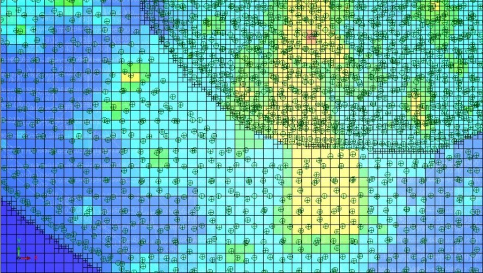

By using this methodology, the geologist has the capability to select an appropriate block size for each domain. An example of the result is provided below:
Variable Sub-celling in GEOVIA Surpac 6.8
