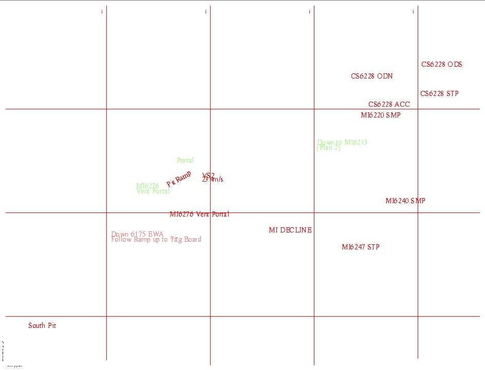

The Emergency Plans typically have a text file containing all symbols and text that the Surveyor overlays onto an updated string and stope outline file. For this particular example, the original text file plot with the associated symbols and text was used with A3 emergency plans. This text plot now needs to be used for the A0 Mines Department plans. To save time in reproducing all the plans with the text, we recommend setting up plotting macros.

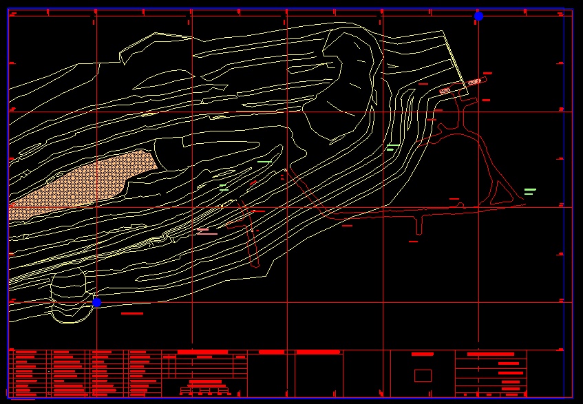

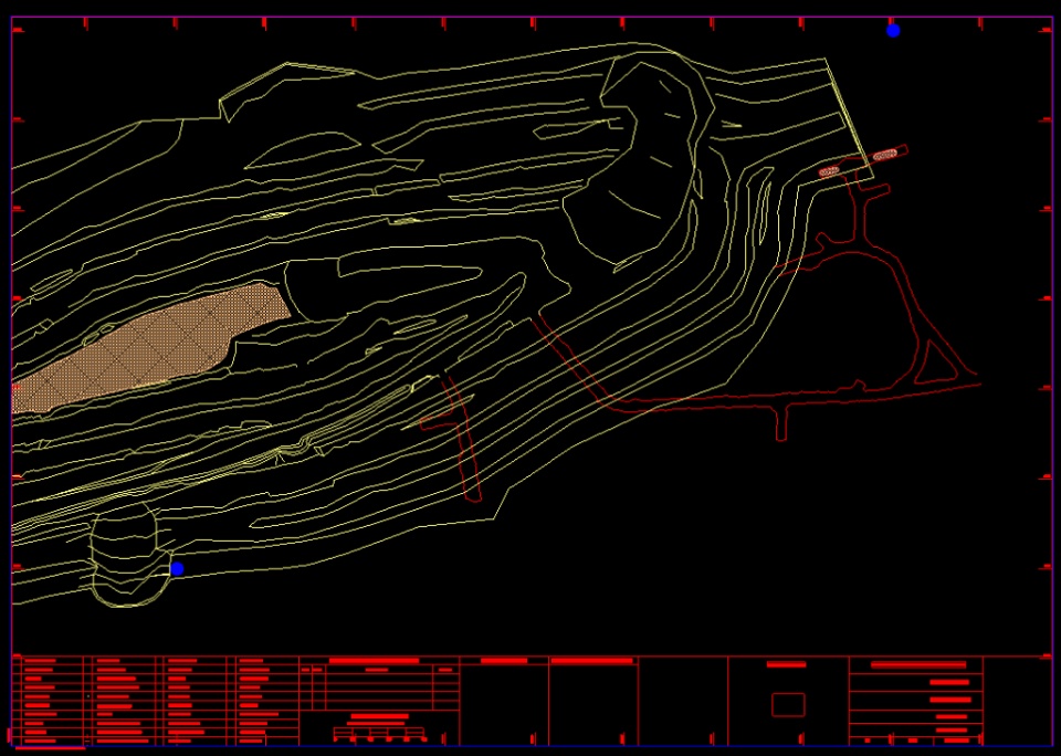

1. Open up the A0 level plot and the A3 text plot files in Surpac and export each to a dxf file format. File>Export plot file to DXF
2. Drag and drop the DXF files into the Surpac graphics window and save as string files.
3. Look at the grid co-ordinates and locate or create common points on each of the plots. A minimum of 2 common points is required to scale (I am assuming this is right?) In this example the A3 has a full grid, and the A0 only has grid ticks on the boundary. The common points are marked as a large blue dot.

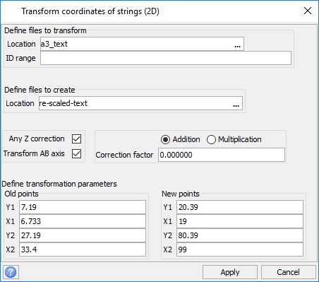

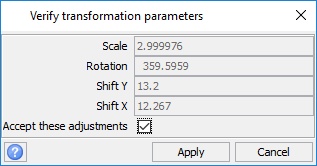

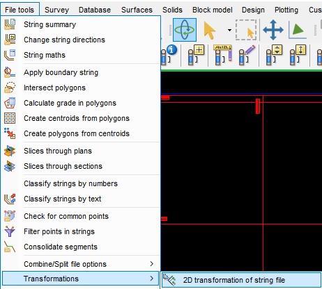

6. The A3 plot now needs to be re-scaled to A0. This can be done using 2d transformation. File Tools>Transformations>2D transformation of string file.
Tick the box and accept the adjustments and apply.
7. Open up the re-scaled A3 text dxf-string and the original A0 dxf-string. They now plot over the top of each other.

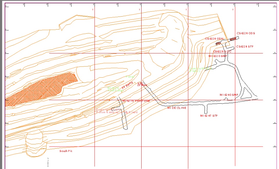

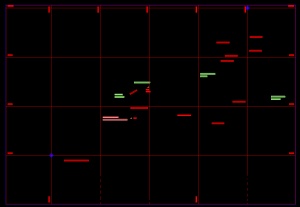

8. To get the A3 text to match the scale of the A0 plan for this example you need to generate the plot at a scale of 1:100. Use Autoplot and plot the text with the border and grid lines. The grid will help you make sure the scale is correct and help you calculate the x and y moves during the combining (appending) process. The result is shown below.

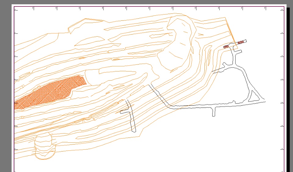

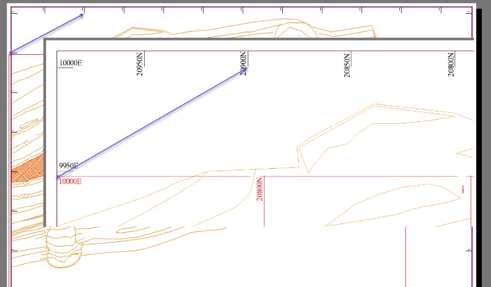

11. The text plot will be appended to the A0 plan plot. BUT it wont be in the correct postion due to different area’s covered by the to plot as you can see.

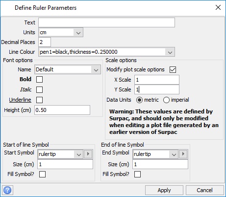

12. Using the Ruler we can measure the distance for the X shift and the Y shift.
Make sure you set the scale for the ruler to be 1, and measure the distance for the move. We need to move the x 18.48cm and the Y 10.49cm.

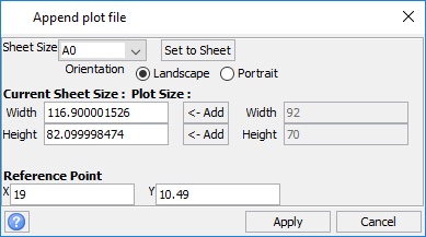

13. Repeat step 9, but now fill in the x and y Reference Point.
NOTE: if you get an error message that says “this plot has been placed such that part of the plot may be outside the page boarders. Either increase the page size, or reposition the plot” Refer to QA00000058846
14. Once you are happy with how it sits, save the new plot.
