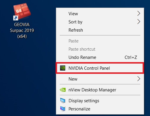

1. Right click on the desktop and in the menu select ‘NVIDIA Control Panel’.

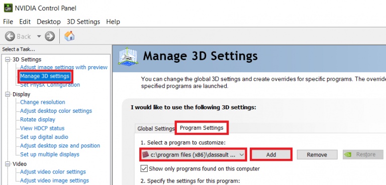

2. Once inside the ‘NVIDIA Control Panel’, navigate to ‘Manage 3D Settings’.
3. Click on the ‘Program Settings’ tab.
4. Either select Surpac from the drop down or click ‘Add’ to add the relevant executable path.

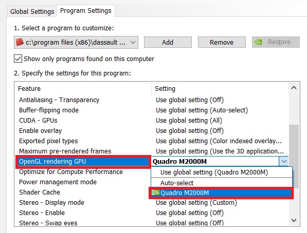

5. Lastly, ensure ‘OpenGL rendering GPU’ is set to the NVIDIA Card (see image below).
6. Click Apply in the form below and restart GEOVIA Surpac for changes to take effect (if open).
