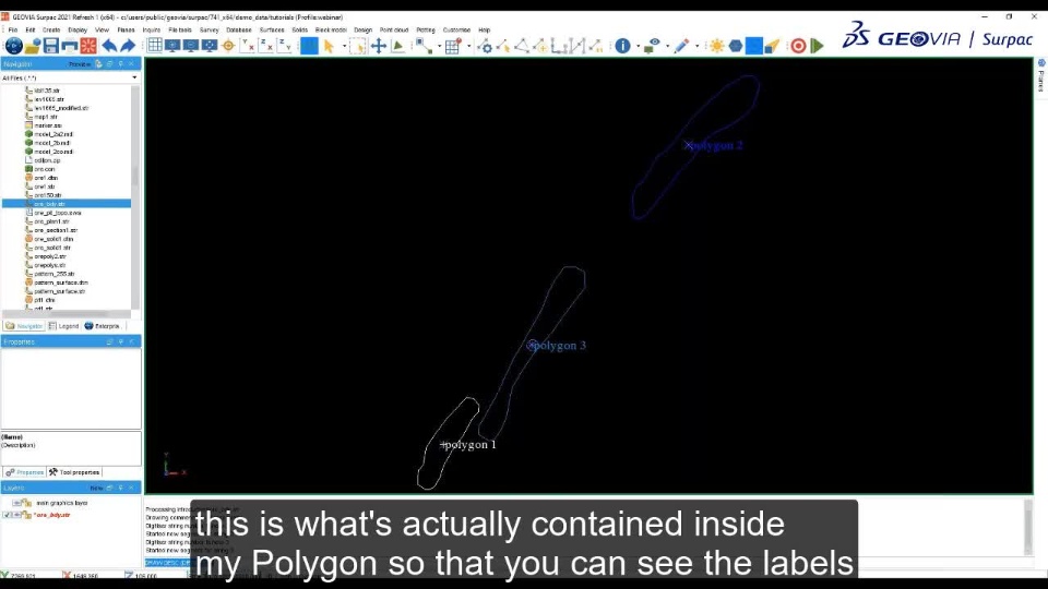

Surpac tip - How to get Dfield information to display when converting string to DXF
It is very common for Surpac users to export out string files as DXF files. Whether the DXF is going to another GMP or being used for machine control, quite often description information is also required. This short video explains how we can get the description information to be exported with the DXF.
There are also macros that do a nice job of converting string files to DXF and I'll be attaching them to this post soon so keep an eye out for those.
