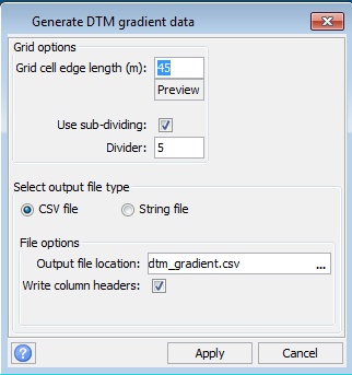

In the form that appears, select the grid spacing you wish to use. This can be visualised to aid in selection.
Select the output file type – in this case we will select .csv and specify the filename to be used. It is advisable to check the box to include column headers.

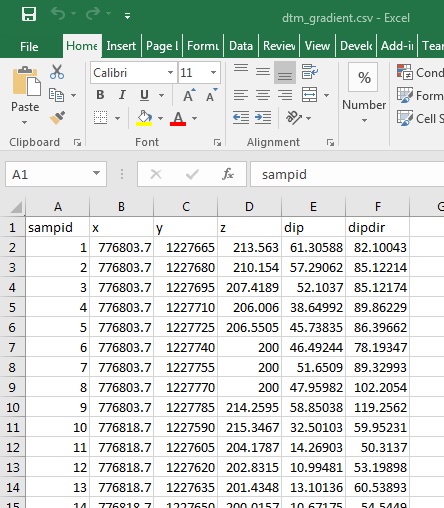

The result from this will be a csv file, saved to the working directory, with the following columns: sample ID, x, y, z, dip, dip direction.
Please note that Surpac uses y,x,z for 3D points, and that therefore these columns will need to be specified carefully during the import process.

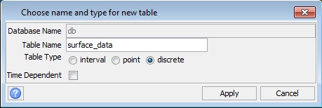

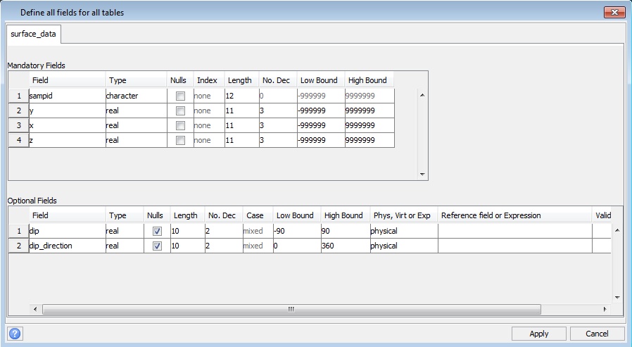

Create a new table for the database (database>database>administration>create table). The table type should be “discrete” and optional fields for “dip” and “dip_direction” should be created.
Don’t forget to make sure that lower and upper bounds make sense for the information being recorded.

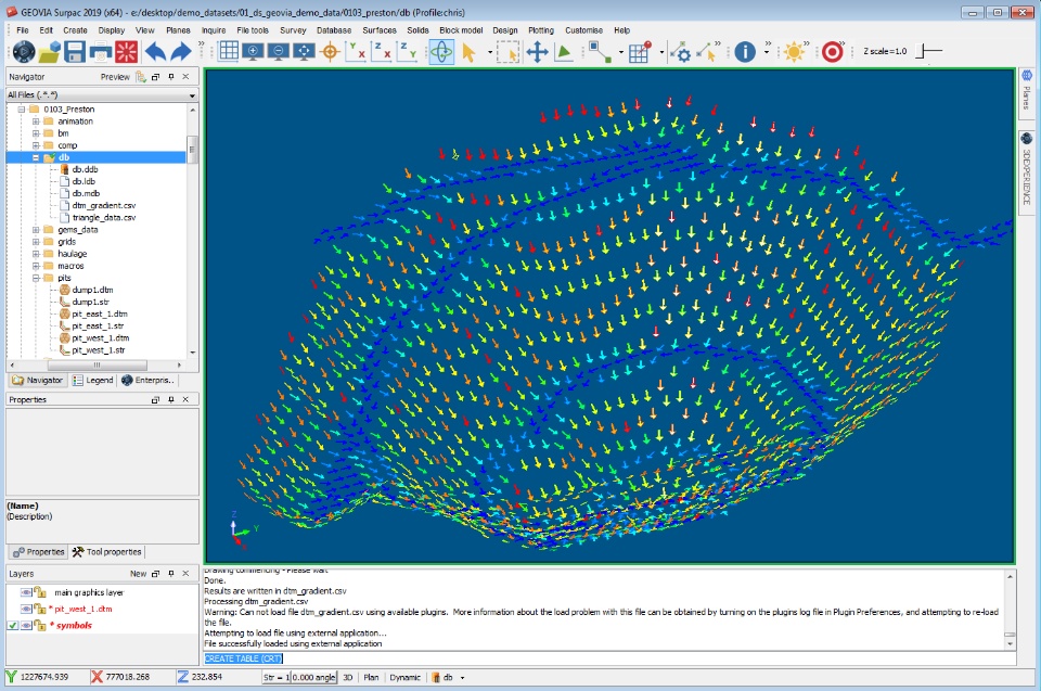

After the import of the data, we can use the data visualiser to display the information taken from the dtm.

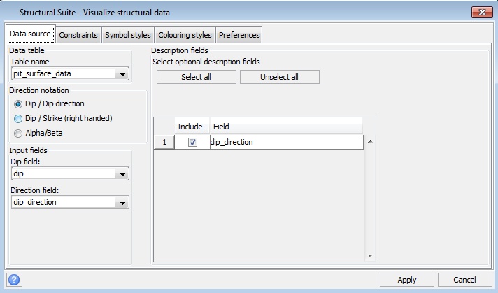

Select Database>Structural Suite>Data Visualiser and complete the form.
In this example, we will make selections such that arrows are displayed showing the dip direction, with colours showing dip ranging from blue (shallow) to red (steep).
By changing the specifications made in the data visualiser forms, we can change the type, size and colour of the icons used to display out data if we wish to do so.
The symbols displayed are placed in a new layer within Surpac, and can therefore be saved as a .str file for later use.
