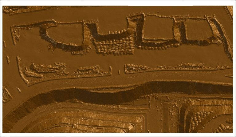

​​​​​​​Point clouds with RGB colours can easily be visualised and meshed in Surpac, but the potentially valuable colour information is lost when creating mesh from point cloud. This blog post demonstrates how RGB point cloud of topography, converted to string file, can be used to easily create a greyscale coloured surface model.
Two large area survey methods are commonly used in mining industry: 3D photogrammetry and laser scanning. Ability to display textured meshes of surfaces created with any 3D photogrammetric software has been great new feature since introducing the .OBJ file format support with Surpac 6.8. These textured meshes are in many scenarios more convenient to use than RGB point clouds and are often easier to digitize features with.

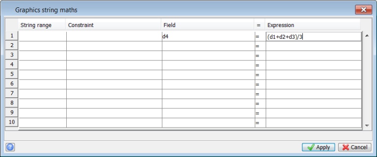

Next step is to calculate greyscale colour values into your DTM. This is done by opening created surface file into Surpac graphics and running LAYER MATHS function. This function is available by right clicking layer in Layers window and selecting “Maths”, or alternatively from menu Edit -> Layer -> Maths).
Easiest way of calculating greyscale value is just to take average of RGB components. Assuming that RGB values are stored in description fields D1, D2 and D3, enter the following equation on layer maths form:
d4 = (d1+d2+d3)/3
This will calculate and store average value of red, green and blue channels into description field D4 of each point in underlying string file. Check the results with IDENTIFY POINT function to ensure that D4 does contain the average value. Remember to save your DTM layer after this!

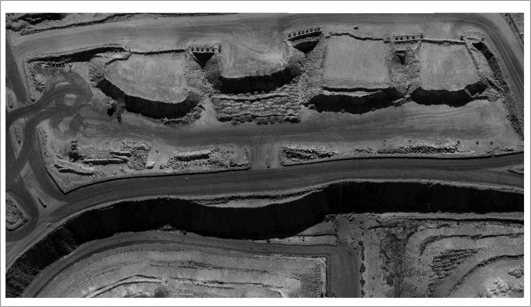

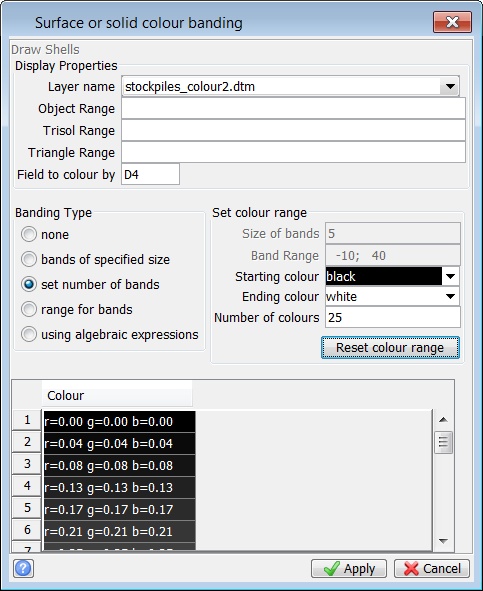

We can now colour the surface model using the value calculated into D4 field. Run function DRAW DTM/3DM (Display -> Draw surface or solid with colour banding). Set field to colour by to D4. Set method to “set number of bands”, select starting colour to be black and ending colour to be white. Number of colours should be set 25. Press “Reset colour range” to get new palette updated to the table below. Press Apply.
The surface is now shown with greyscale colouring. You can further enhance the effect and make surface look better by turning off all lights (LOFF).

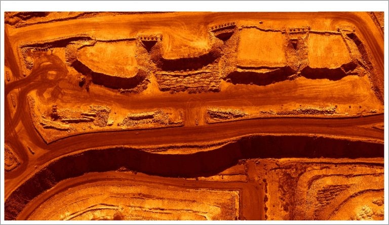

Try to experiment drawing surface using different RGB channels (change field to colour by to D1 to colour by red channel). You can also use other colours than black and white to create false colour images.
