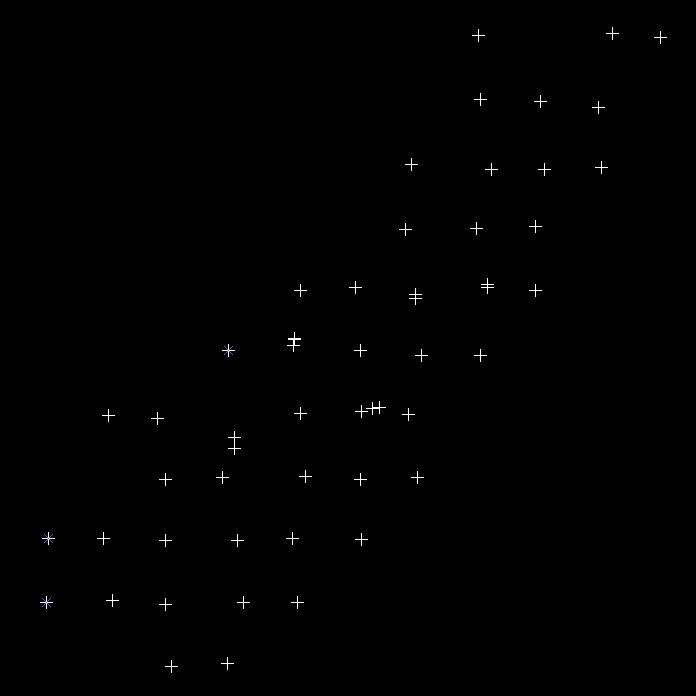

  1. In Surpac, open the soil sample data into the graphics layer.

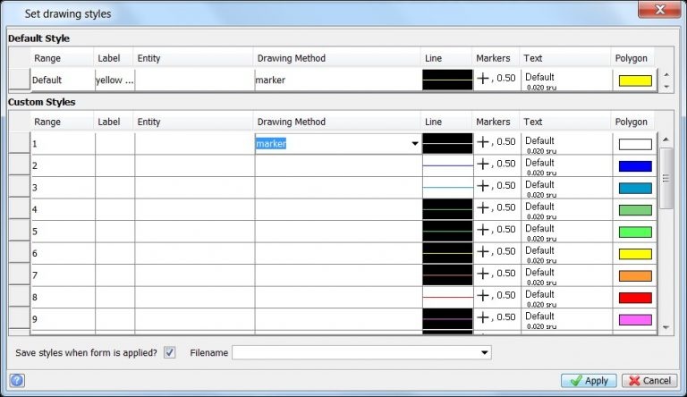

2.  Go to Customize > display properties > strings and points, then change the drawing method to marker. You can then save the styles file if you wish, or leave the line blank, which changes the display on the fly, for the creation of the DTM.

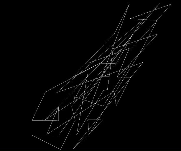

3. Next, go to Surfaces > Create DTM from layer. There are two plane types the DTM is created on, “best fit plane” and the “the xy plane”.
Note: Make sure you view the resultant DTM, as the two plane types produce different results.
4.  Save the DTM that best fits your data.

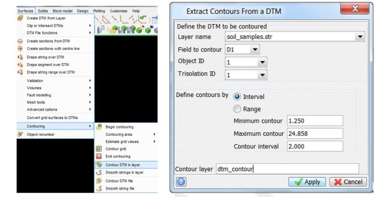

6. Select Surfaces > Contouring > Contour DTM in layer. Note that if your dataset is big, it is recommended to use the file-based method (Surfaces > Contouring > Contour DTM file), rather than the graphics-based method.

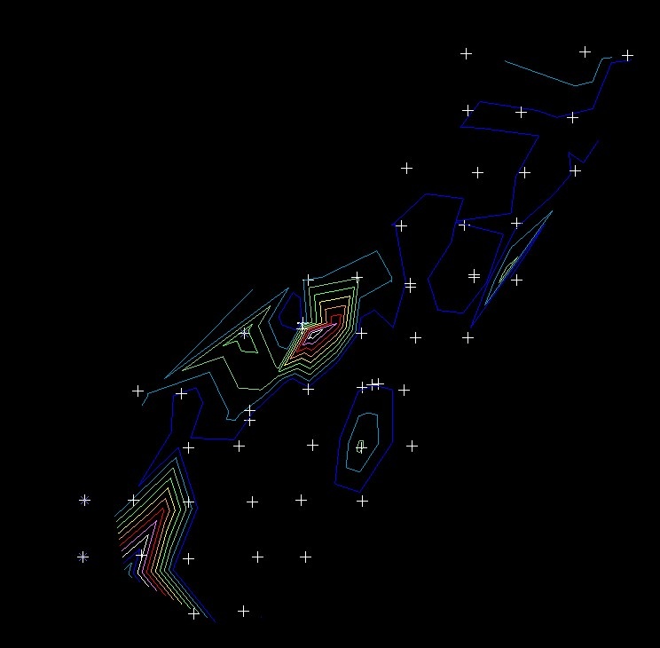

7.  In this example, the result is written into a layer ‘dtm_contour’.
With assay data now displayed as contours. this may assist in interrogating the data for the purposes of refining drill targets, assist in resource modelling or conceptual mine design.
