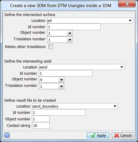

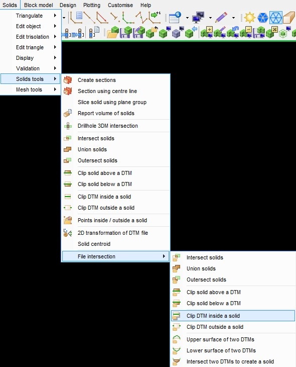

1. Firstly, open up Surpac and go to Solids > File Intersections > Clip DTM Inside a Solid.

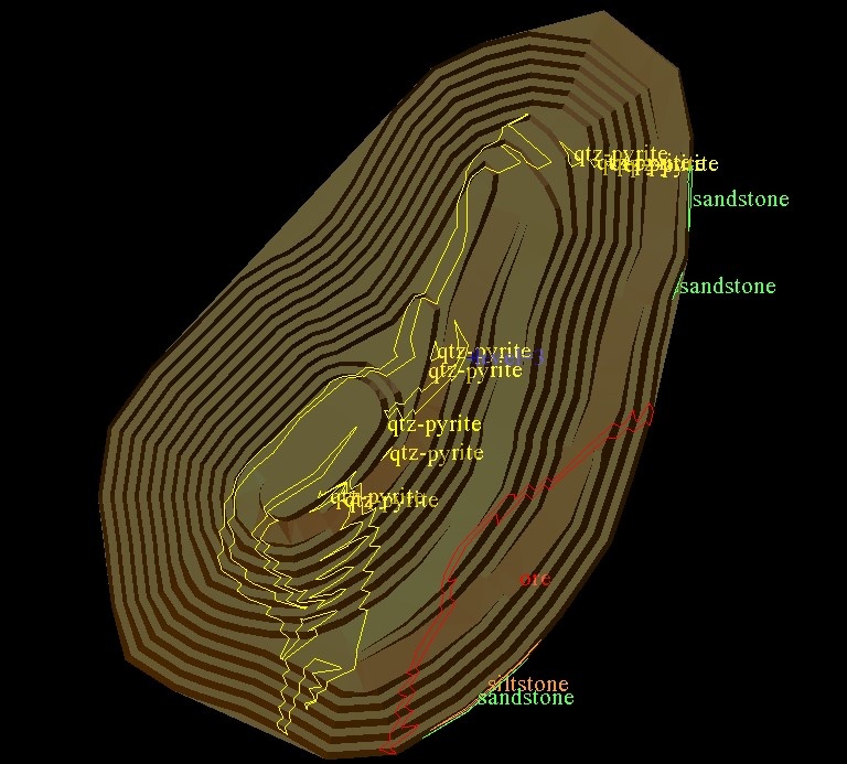

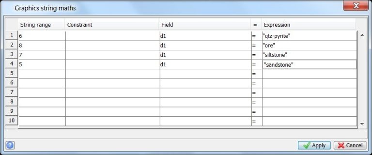

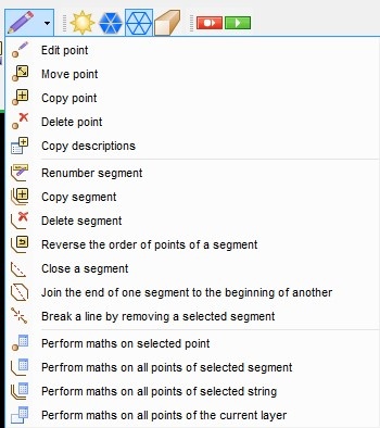

2. The contact strings will be numbered 10. Open up each of the files and delete the unwanted string and renumber to the color for that particular geology code. Ensure that the strings are clockwise and closed.
3. The contact strings will be numbered 10. Open up each of the files and delete the unwanted string and renumber to the color for that particular geology code. Ensure that the strings are clockwise and closed.

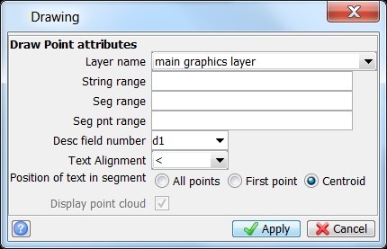

4. Display the d1 field in the centroid position and check the descriptions are correct.

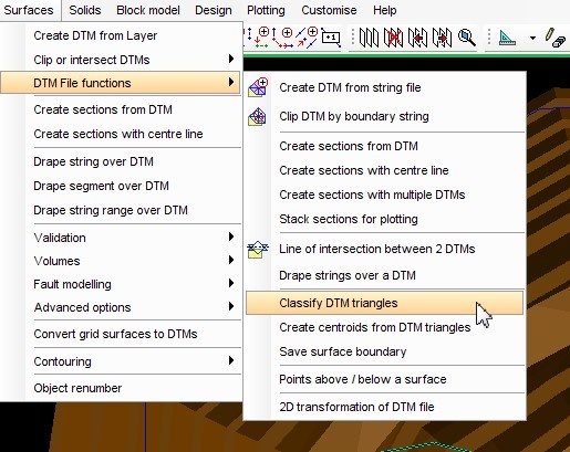

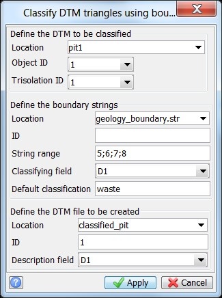

5. Go to Surfaces  > DTM file functions > classify DTM triangles. Fill in the following form. Remember to make sure the string range matches what is in the form.

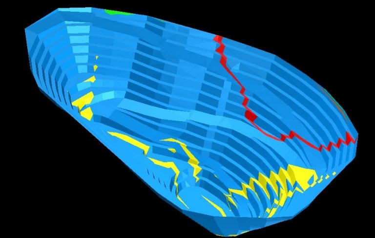

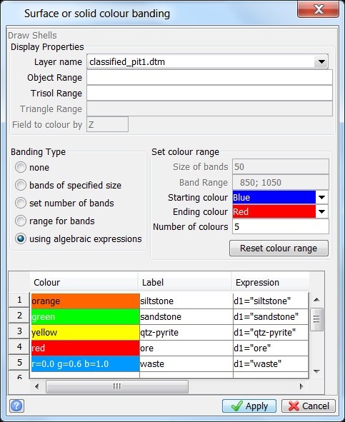

6. Open the resultant DTM and color.
7. The DTM will then be coloured by geology (see below example).
