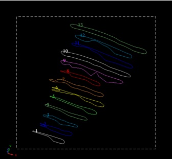

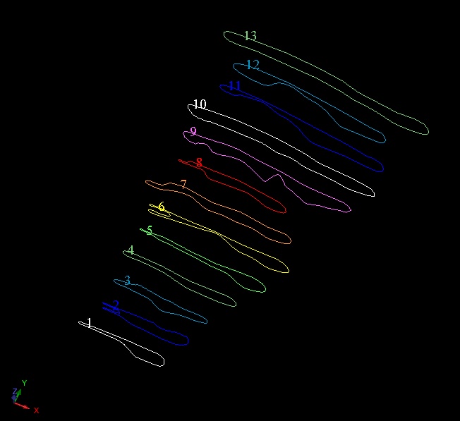

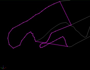

If you are working with digitized closed segments with increasing string/segment number order, you can create the solid model in a quick manner. The image below shows the digitized segments for solid model wire-frame in ascending string number:

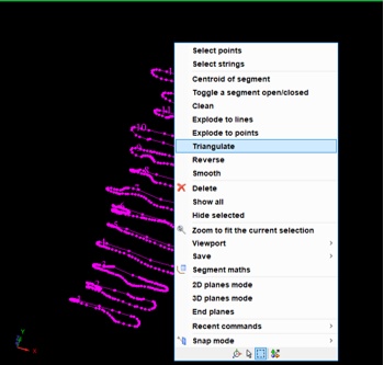

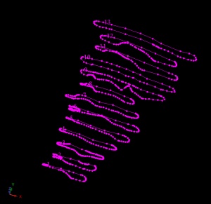

Actually, the fully automatic solid creation is hidden. Use “Box select points” icon to select all points within the segments and drag the box to select all the points, then right click in the graphics and select “Select segments”:

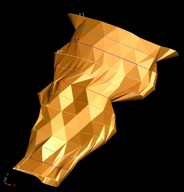

Then right click on the graphics and select the function “Triangulate”; this will create the triangles automatically between the segments:
This is the easiest way to triangulate when there is little complexity in the solid model shape.
To proceed further, you can close both the ends by selecting Solids > Triangulate > Inside a segment to create a valid 3DM file.

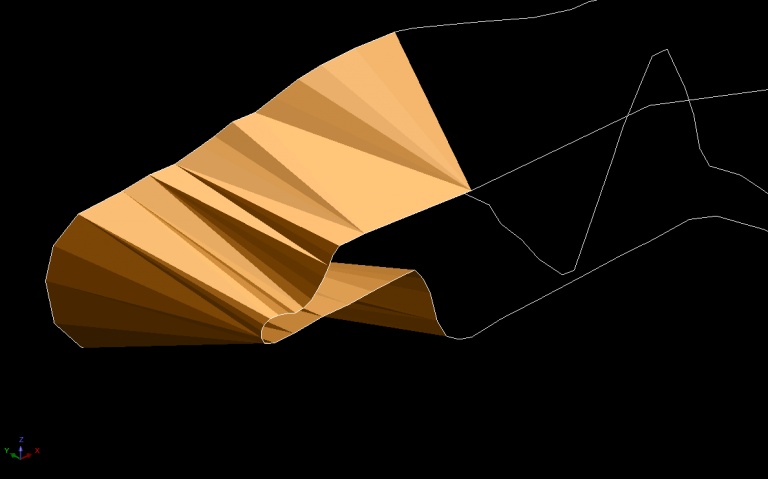

As mentioned earlier, sometimes you may need to connect each points manually to give a proper shape to your complex solid model.
Select “Triangulate shape tool” icon , then click on a particular point on a segment and then move your cursor along the segment to highlight more points. Move your cursor to continue and go back to your original point. It will create the triangles within the selected points only. Use the same technique to complete the other portion.
While using this manual method of triangulation, you can change triangle object & trisolation properties through “Tool properties”:
