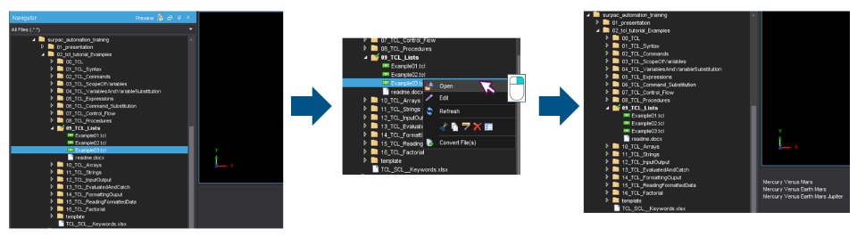

How to Execute Scripts
  1. Download and unzip SurpacHelp_TCL_SCL_Scripts.zip to an arbitrary folder
  2. Set the script folder as the work directory
  3. Run the example TCL scripts, by either right mouse-click open or by dragging the script into the Surpac graphics window
