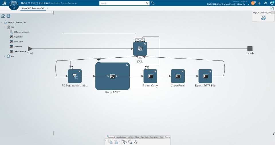

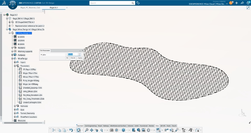

In the illustration below (see graphic), a DoE is used to update the mine design for a block cave to see the effect the different mine design has on various Key Performance Indicators (KPI’s)  such as Internal Rate of Return (IRR), Net Present Value (NPV) and overall grades/tonnes. Using process automation applications, we can integrate various tools to simulate the design and scheduling.  In this example, we created a simulation that used a DoE to modify the parameters of the mine design, such as tunnel spacing, azimuth and draw bell spacing to create the output design.  Then the simulation uses the newly created draw point locations from the output design to create the production schedule of the block cave, which would determine the reserves, tonnes, grade and schedule of the mine.  The DoE collects all the output data of the various scenarios so the engineer can quickly evaluate the effect the various input parameters had on KPI’s such as IRR and NPV.

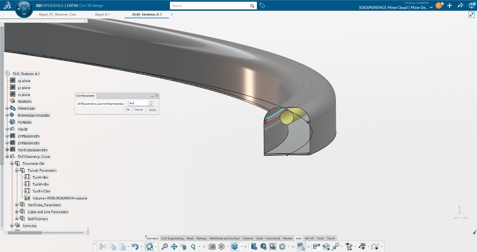

A similar concept could be applied to different processes or mine designs.  For example, by changing various parameters, a model could calculate total design length as an output used to generate a cost for the design and to compare alternatives.
