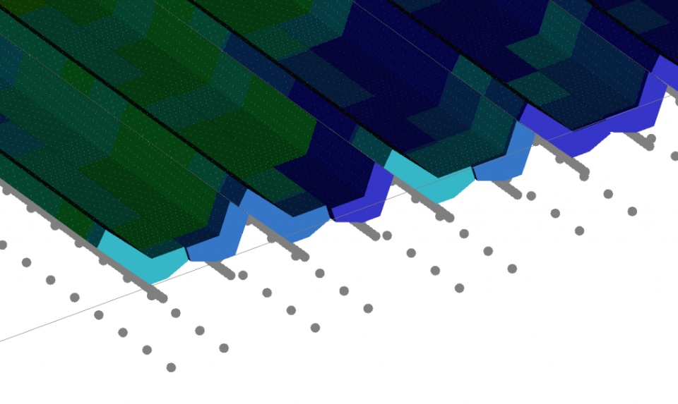

3D view of Undercut rings
Design the undercut level with exact ring shapes and precise grades

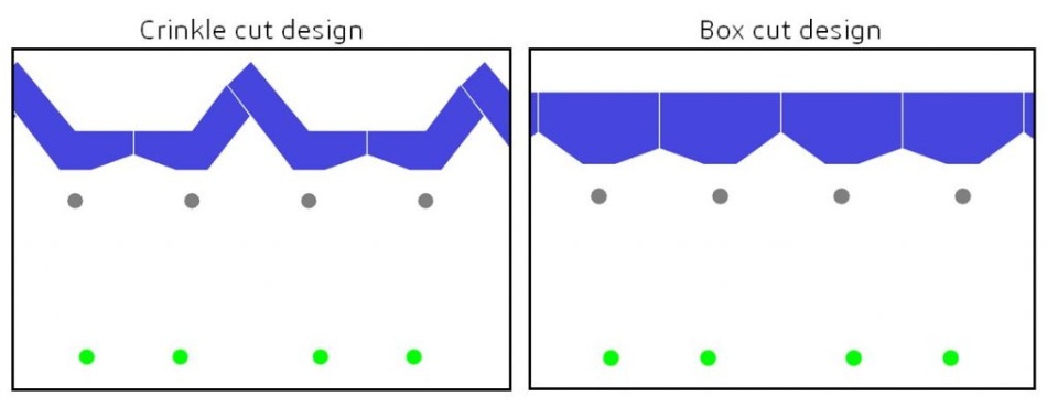

The entire undercut level can now be designed in PCBC including all of the undercut tunnels and undercut rings. Different undercut ring designs such as the crinkle cut or box cut can be applied to the ring shapes. The new undercut tool can also incorporate slot rings and slot tunnels into the design.

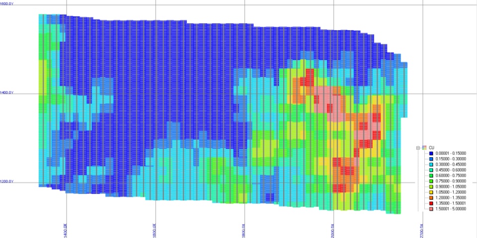

The tonnes and grade of each ring is calculated directly from the block model and reported in Excel. Undercut rings can be displayed as 2D projects, polygons, or 3D solids showing different grade values. Plus, ring properties can be easily edited in Excel or graphically.
Plan view of undercut rings showing copper grades
Cross section showing crinkle cut design and box cut design

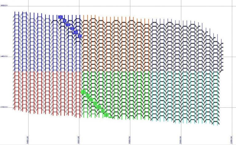

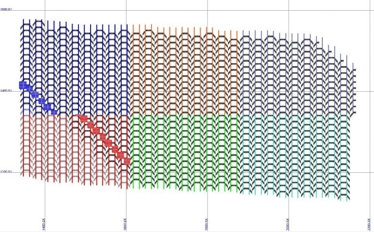

With the new undercut tool, every time a new undercut scenario is created the draw bells will automatically get sequenced. Draw bells can be sequenced using pre-undercut or advance-undercut strategies. An opening radius is applied such that the draw bells are sequenced once the undercut rings have been blasted and mucked out.
If the draw bell construction happens to be the bottle neck for production then the undercut sequence can be modified to match the draw bell sequence or vice versa. The draw bell sequence can also apply a smoothing factor to open draw bells in regular intervals. There are also graphical playback tools to display the undercut and draw bell sequence over time.
Plan view showing which rings are blasted in the current period.
