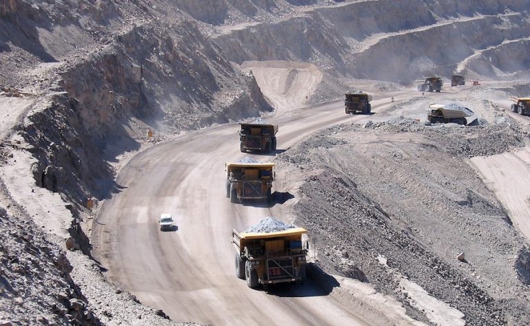

Rimpull tables are used when the truck is hauling upwards (increasing inclination/elevation) whether loaded or empty and the Retard tables are used to calculate the truck’s velocities when it is hauling downwards (decreasing inclination/elevation).
For example if a truck is hauling from the inside of an open pit to a stockpile or processing plant on the surface, like in Figure 1, the Rimpull tables will be used to calculate the truck’s velocity when it is loaded, as it will be hauling upwards, and the Retard tables will be used to calculate the truck’s velocities when empty, as it will be hauling downwards.
Loaded Dump Trucks hauling to a higher elevation (Topf, 2017)
Now if mining occurs from a mountain or if the truck is hauling material from a higher to a lower elevation such as in Figure 2, then the truck will be hauling downwards loaded and upwards when empty. Hence the Retard tables will be used to calculate the loaded truck’s velocities and Rimpull tables will be used to calculate the empty truck’s velocity.
Dump Truck hauling to a lower elevation (Caterpillar, 2015)

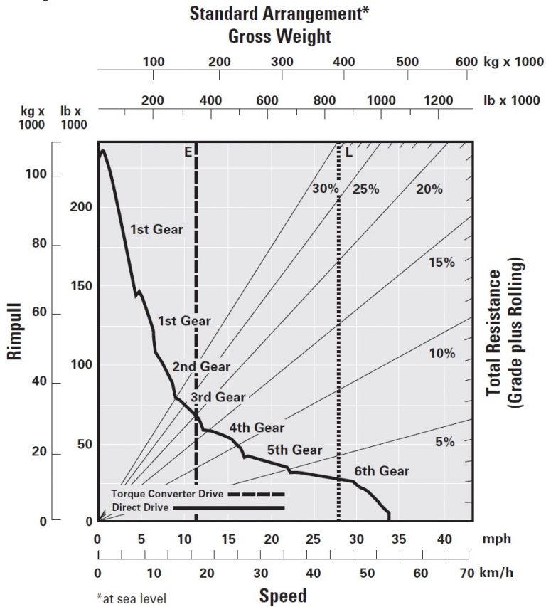

How to use the Rimpull table for Full/Loaded truck
Firstly, calculate the Total Resistance that the truck will need to overcome, which is the grade plus the rolling resistance;
For example, grade = 10% and rolling resistance = 2%, then
Total resistance = 10% + 2% = 12%, then draw a line from a total resistance of 12% to where it intercepts the dotted line for the loaded truck weight, illustrated in red in Figure 3.
  1. From the loaded truck weight-total resistance interception, draw a horizontal line to intercept the highest gear illustrated in blue,
  2. From the highest gear, draw a vertical line downwards and read the velocity that the truck will travel at that grade, illustrated in
  3. Extend the blue line and read the Rimpull value in Kg x 1000, illustrated in yellow.
Note: The Rimpull value in Kg x 1000 will need to be multiplied by the gravitational acceleration (9.81 m/s-2) to obtain the frictional force that the truck will be required to overcome in order to travel at that particular grade and rolling resistance. This force will be used in future MineSched versions to calculate the fuel consumption.
CAT 793 Rimpull Table (Caterpillar)
