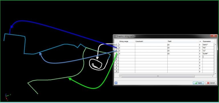

  1. Access the Layer Maths Function in Surpac
  2. Select the description field of your choice, e.g. d3, and enter a unique route name into the Expression field that accurately describes your haul route, e.g. “INPIT”. The below images illustrates only three haul routes for the purpose of simplicity, but you can add as many routes as you want. The white line represents the in-pit common road, while the other coloured lines represent other routes.
  3. Click Apply
  4. Save

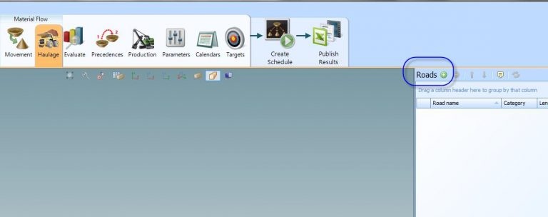

1. In MineSched, click on the green plus sign next to Roads to import your roads.

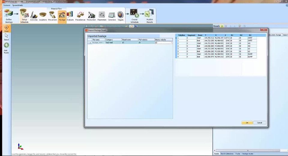

2. Navigate to the string file that you previously saved in Surpac

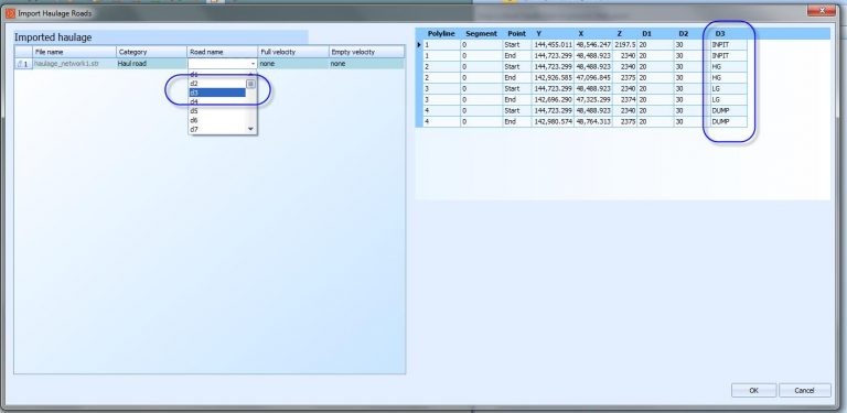

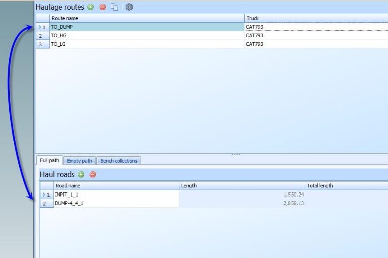

3. Once the desired string file is selected, the Import Haulage Roads dialog box will appear. Map the appropriate description field to the column “Road name”, “Full velocity” and “Empty velocity”. For instance, if “Full velocity” is in the d1 field, select d1.

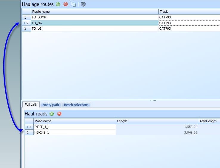

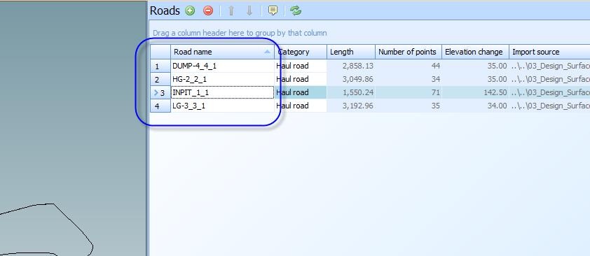

This way, road names become intuitive to the destination as seen below.
For instance, haulage route 1, TO_DUMP, consists of 2 haul roads: INPIT_1_1 and DUMP-4_4_1 which is the pathway to reach the dump.
This is the same for route 2, TO_HG which is made up of roads INPIT_1_1 and HG-2_2_1.
Now that you have imported your haul route names, you can proceed to define the routes in the material movement grid for scheduling.
