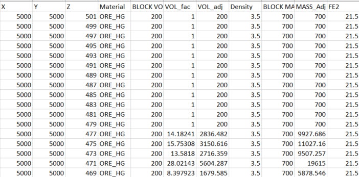

STEP 1: Create a csv with with the field Y, X, Z, Material Class, Block Volume, Volume Factor, Adjusted Volume, Density, Block Mass, Adjusted Mass, and at least one grade attribute
In this exercise, I am creating a 10 x 10 x 2 block model with the following coordinates. However, the coordinates and block sizes do not really matter, it can be any vertical blocks because what we are after ultimately are the adjusted block volume and adjusted mass which represent the underground materials mined each period. We can achieve any volume and mass with the use of a volume adjustment factor.
First divide the adjusted Mass (the Mass of material we want to mine each period) by the density to get the adjusted volume, then divide the adjusted volume by the original block volume to get the volume adjustment factor that we will use in MineSched later on.

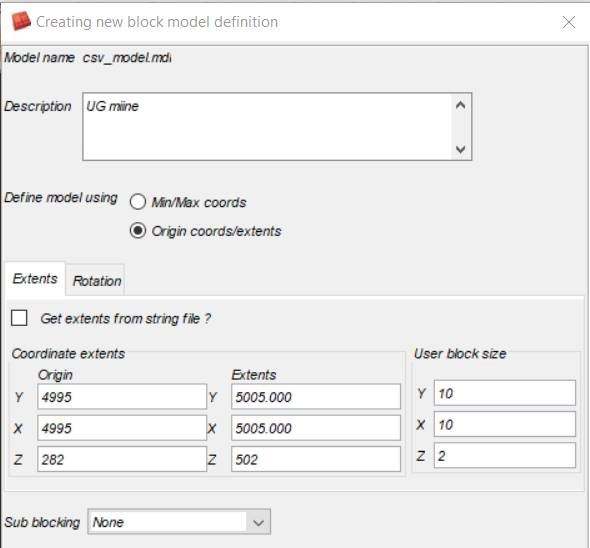

STEP 2: Import the csv model into any GMP block model. In this exercise we will use Surpac model (.mdl)

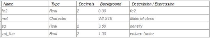

  1. Create the model space
2. Create attributes in the new model then save model

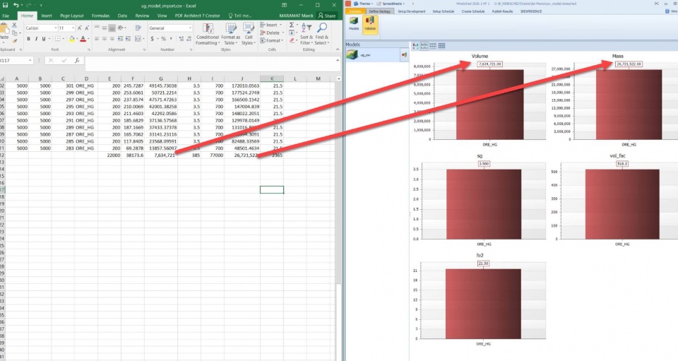

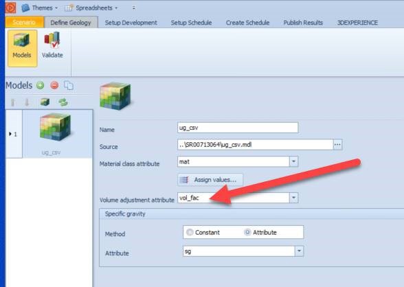

STEP 3: Import the new model in MineSched
STEP 4: Extract Material Class. In this case it’s just ORE_HG
STEP 5: Extract Qualities
STEP 6: Check for model errors then validate.
STEP 7: Import the LOM Model, extract material classes and qualities, check for errors, then validate as you did for the UG production model.
