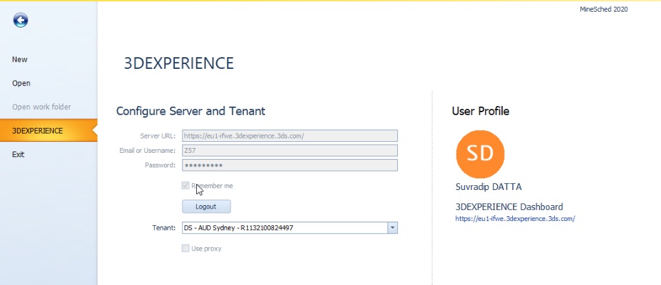

Connect to the 3DEXPERIENCE platform from the GEOVIA MineSched 2020 interface
Login into your designated tenant with your credentials, where you would like to upload the scheduling animation result.

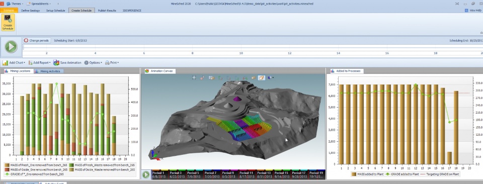

After successful login, run the schedule into MineSched and generate scheduling output with animation.

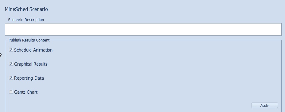

MineSched POWER’BY

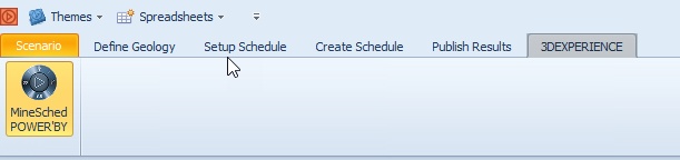

Go to 3DEXPERIENCE tab in MineSched and click on MineSched POWER’BY

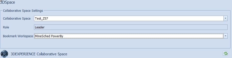

Select Collaborative Space from the specific tenant and bookmark work-space for storing the files into 3DEXPERIENCE platform.
Then choose the results you would like to import into 3DSpace and click on Apply.
All data will be automatically stored into specified 3DSpace in a structured manner, which can be shared with other stakeholders for effective enterprise collaboration.

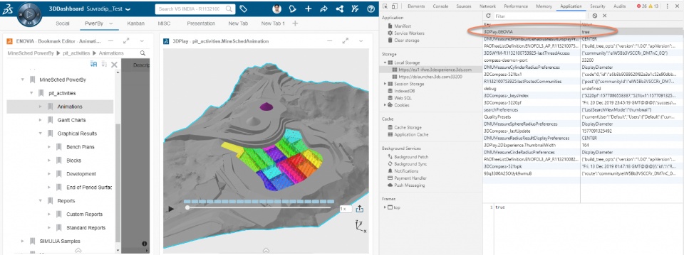

*if 3DPlay is not supporting *.mineschedanimation file; press F12 from the keyboard and manually add a variable in the browser (chrome preferably) 3DPlay.GEOVIA = true (as per the below screenshot).

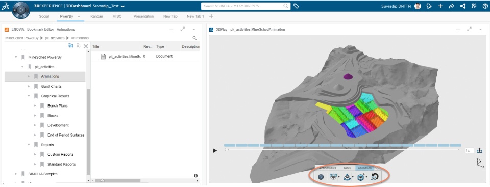

Here in this example, one dashboard has been created with Bookmark Editor and 3DPlay widgets.
Drag & drop the *.mineschedanimation file from Bookmark Editor widget into 3DPlay, navigate through the animation for better visual validation of your mining progress.
It also allows you to display/hide mining activities or stockpiles associated with that particular animation.
