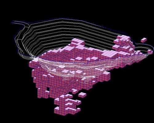

1. In Surpac, open your block model and create a block model constraint to see the selection of blocks you are interested in, for example ore reserves only or high-grade blocks.
2. Use the function Block Model > Export > Block Faces to DTM to save the selected blocks as a solid.

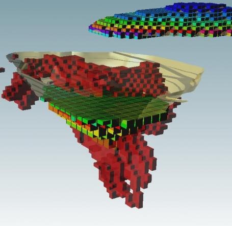

Open MineSched and access the layers button on the animation canvas (or in any other mode). Add the DTM. You can also select the color and relative transparency.
3. Your block model visualization should look similar to this:

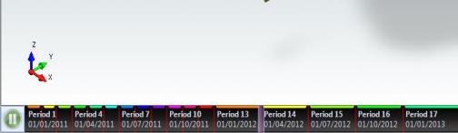

You can reveal the DTM by playing back the animation or by stepping through the periods by using the right arrow on your keyboard.

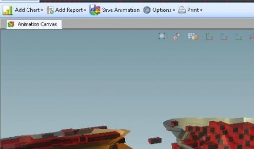

4. As with any layer added to the animation (pit surfaces, topographies etc), the block model visualization will also be maintained in the animation. This can be shared outside of MineSched with other colleagues or stakeholders, using the Save Animation button.
