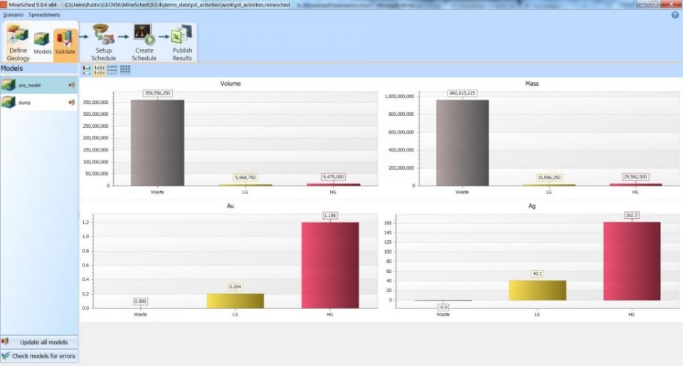

Once your scenario is running in MineSched, select the tab that contains the image you need. In this example, we are using the images under the Validate tab.

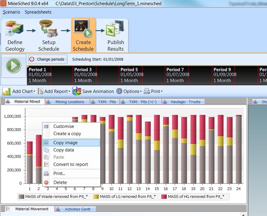

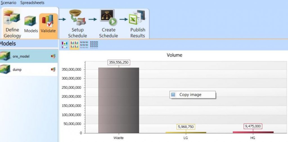

Right click on the image and select the option to copy (“Copy image”)

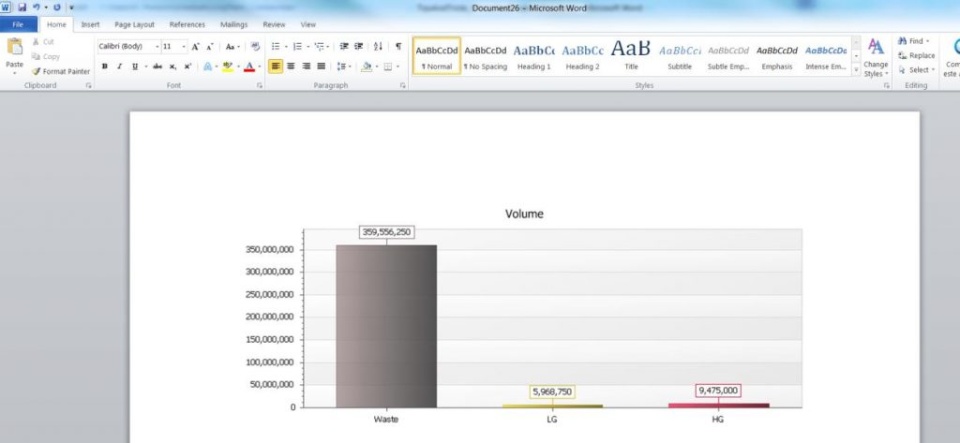

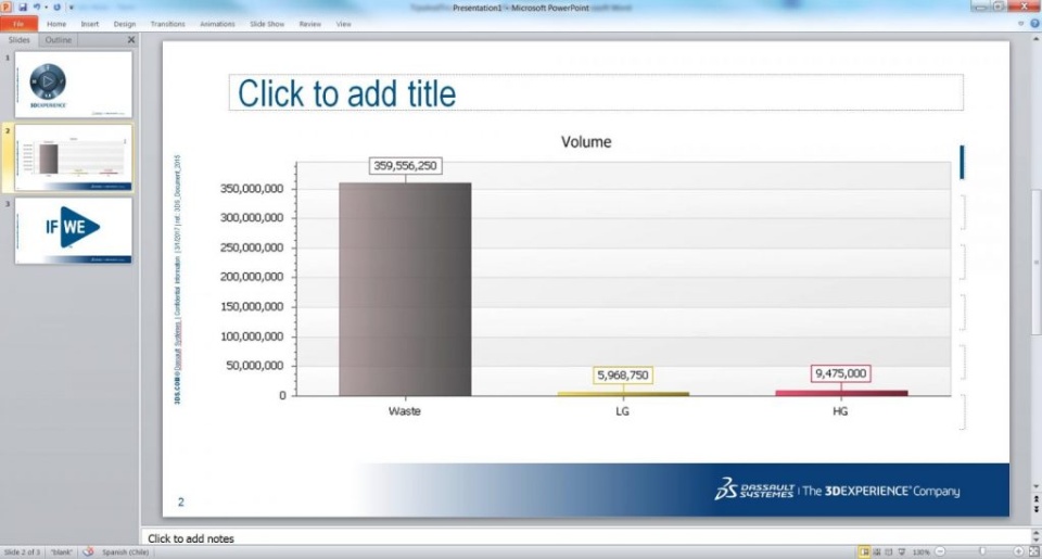

Open your desired application and paste the image. In this example, we’re using Microsoft Word and Powerpoint.

You can also copy and paste charts from the Create Schedule tab.
