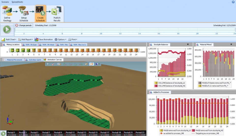

Long time MineSched users will remember the days where, in order to see a schedule animation, you had to kick the graphical results back into Surpac. Embedding the animation canvas into the MineSched dashboard has remarkably improved the MineSched experience.

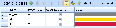

STEP 1:  Take note of the material classes that are setup in the block model for MineSched. It is also helpful here to remain consistent with your coloring scheme.

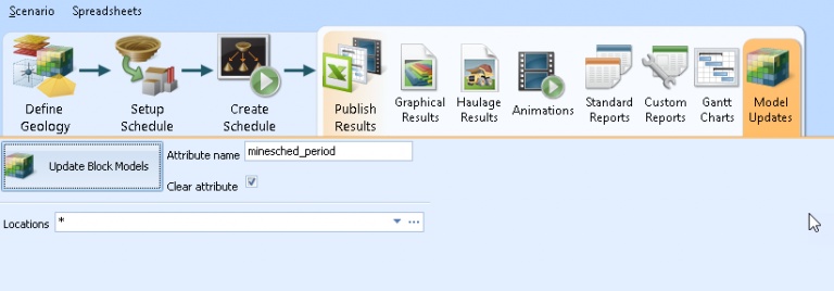

STEP 2: In the Publish Results ribbon choose the Model Updates tab. You can select a name for the new attribute it will create in the block model, or use the default minesched_period. Make sure option for Clear attribute is checked on, this will eliminate any risk of combining the results of multiple exports to the block model. Hit the button to Update Block Models.

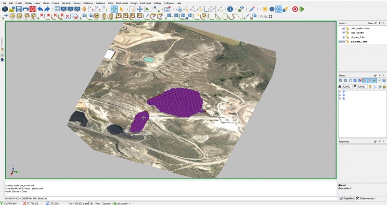

STEP 3: Open the block model in Surpac. *if the block model was already open in Surpac, you will need to close and re-open since MineSched has changed the mdl file.*

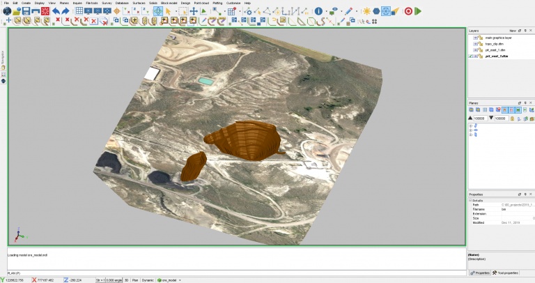

STEP 4: In Surpac, open any additional data to supplement the animations like surfaces, solids, or drill-holes. In my example, I am using an aerial photo draped onto the topography surface, and two pit designs.

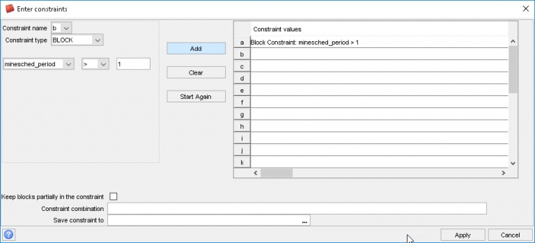

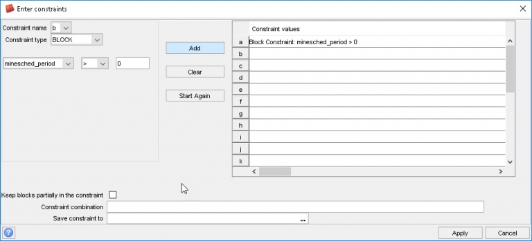

STEP 5: Now to display the block model. The block model attribute we created earlier in MineSched, minesched_period, has a background value of -999, so if we use a block type constraint for minesched_period > 0 this will show all of the block model blocks that will be mined in the schedule.

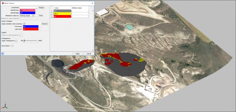

STEP 6: Now we can color the block model to match the material classifications in MineSched.

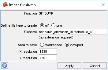

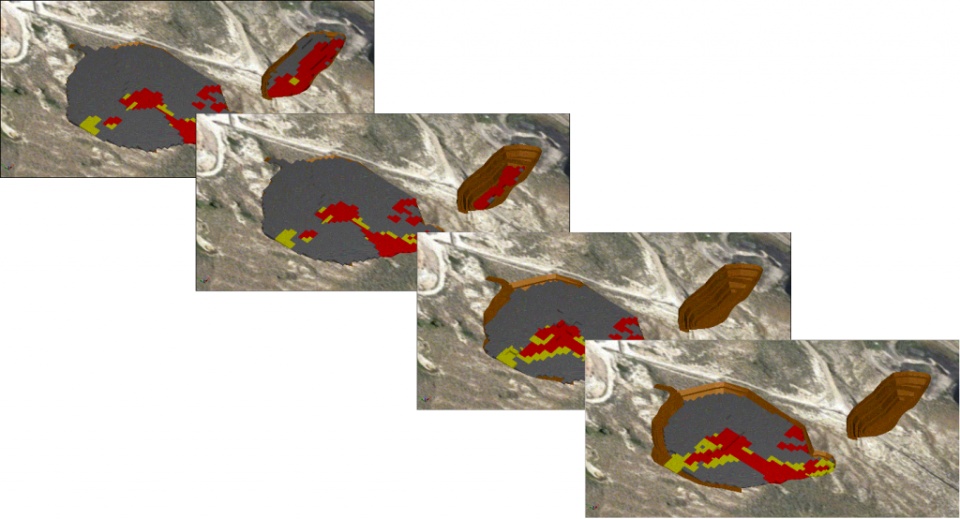

STEP 7: Finally, we can take a snapshot of the starting point for our animation. For this, I will use function File > images > save an image which simply saves a .gif or .png of the current view. I put this first snapshot into an empty folder and flagged the file as period 0.
The gif file created can be opened and viewed in your favorite image viewing application.

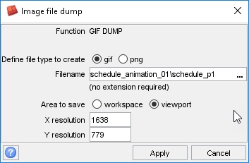

STEP 8: To create the image for the first period we simply need to update the constraint with the next period number and take another snapshot. These tasks can be repeated for every period in which you would like to capture an image.

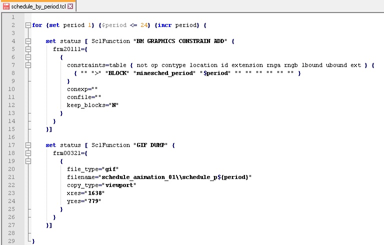

Repetitive processes like this are very easy to speed up and automate using TCL and this a very easy macro to put together. The macro below uses a for loop to repeat the process for all of our schedule periods.
STEP 9: After creating all of the images needed, they can be viewed in order to watch the progression of mining.
