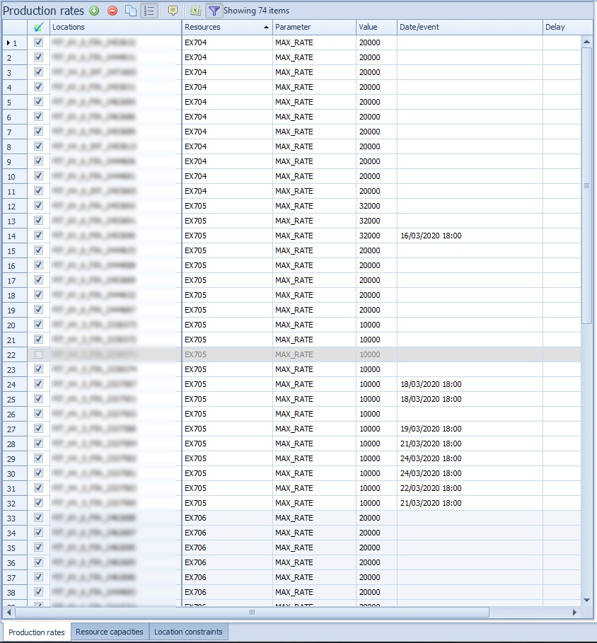

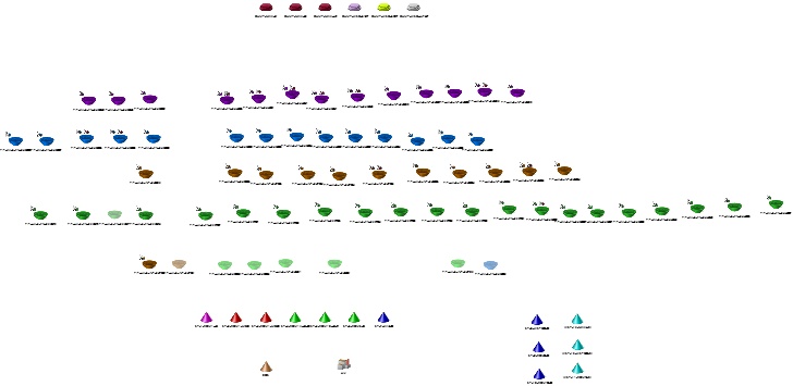

The main issue with all versions of MineSched prior to 2022 was that you had to break your locations into the smallest component to have the necessary control for scheduling all mining and related activities. This forced users to go from having 1 location with many polygons or solids in it to having potentially hundreds of locations with each location representing a single flitch in one blast polygon. This meant your location canvas could become cluttered (See below) and managing the rules associated with all these locations was difficult.
Location setup in versions prior to 2022
Production rates data grid in versions prior to 2022. Many rows to control equipment.

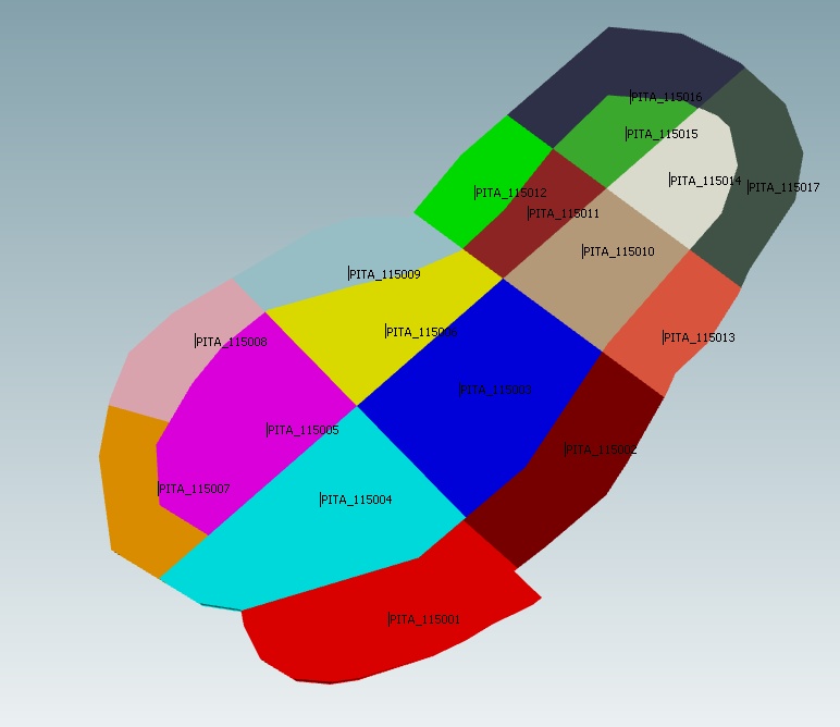

What’s changed in MineSched 2022?

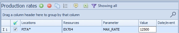

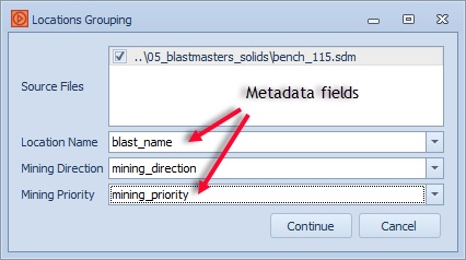

MineSched 2022 allows the grouping of locations into “Collections”. This change allows material movement and production rate rules to be simplified.  Not only that, but MineSched also allows the user to assign Metadata into polygons and Solids using Surpac’s SDM format that can be read directly in MineSched.  We can now assign a location name, mining direction and mining priority, directly to the blast location.
With clever use of some simple macro’s in Surpac, (although not needed) we can import our locations and be scheduling in a couple of clicks.
Locations setup in 2022 with collection PIT_A
Double-clicking on the collections reveals the solids or polygons that comprise the collection.
Production rate rules are kept to a minimum.

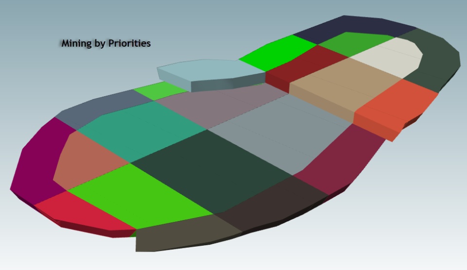

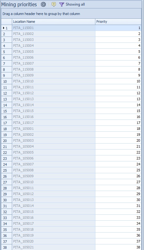

Mining is controlled either by priorities or precedences. (depending on what you are trying to achieve) With priorities already entered as metadata in the SDM file, nothing else needs to be done.
Want to change the order of mining? No problem. Just switch up the priorities.

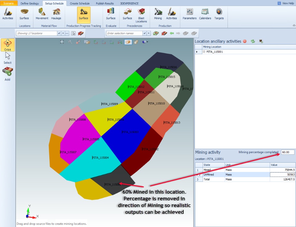

Halfway through a blast location when scheduling?
When short term scheduling, it is necessary to start scheduling runs with equipment already working in the blast locations.  For example, Mining is 60% complete in a location.  We can account for that easily with “Production Progress tracking”.
This also applies to any activities we are scheduling (GC Drilling, Production Drilling, Charging, Blasting, etc).
