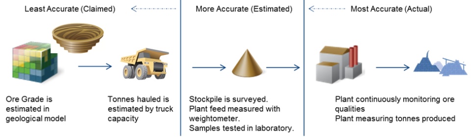

Material Balance uses all recorded information about movements within a mine to balance flows from pit to plant, in order to identify where previously accepted values need to be corrected.
This balance is usually based on a “high-confidence” flowa flow known to be highly accurate. For example, the last movements in the production chain, such as crusher weightometers or finished products, are good starting points for a balance because the output measurements from these envelopes are definite, meaning they have a high-confidence value that needs no correction. From there, material movements between envelopes must balance, so you can change other flows to bring them into line with the high-confidence flow.
The process is iterative, moving back to balance the previous envelope in the chain, and so on, until reaching the mine source.

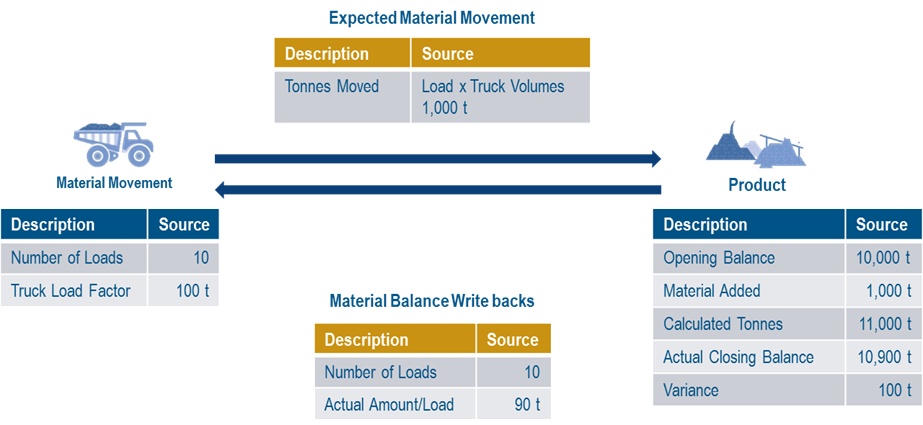

Typical Material Balance Diagram

Because, in a complex mine production process with many flows, the same data can be measured several times with different accuracy, you can also account for inaccuracy. Material movements from more accurate envelopes will adjust measurements from less accurate envelopes so that they balance. In addition, because the movement and adjustment of numbers will grow increasingly more complex as more material flows throughout the movement chain, a typical balance calculation also involves adjusting movement quantities based on opening and closing survey differences.
For a stockpile, for example, the following formula, derived from the law of conservation of mass, would be used:
Opening Balance + Inputs – Outputs – Closing Survey = 0
Any amount of difference from zero is a discrepancy and is referred to as an “imbalance.” In order to balance this equation, one of the values should be adjusted – typically, the lowest confidence value. If the stockpile’s confidence values looked like this:
Value Type
Data Source
Confidence Level
Opening Survey
Survey
High Confidence
Input (Hauling)
Truck factor * truck count
Low Confidence
Output (Conveyor belt)
Weightometer
High Confidence
Closing Survey
Survey
High Confidence
then it is the truck factor that should be adjusted to balance the stockpile.
Because all hauling input movements need to be proportionally adjusted by multiplication with (900/1000), if the input in this case consisted of 10 Hauls of 100t, the input would be adjusted proportionally – decreased by 100 to 900 – like so: 100 * 900/1,000 = 90. And the new hauling movements would be 90t each.
Imbalanced
Balanced
Value Type
Amount
Value Type
Amount
Open
10,000
Open
10,000
Input
1,000
Input
1,000 900
Output
0
Output
0
Closing
10,900
Closing
10,900
Imbalance
100
Imbalance
0
The change to the truck weights tells the mine that the trucks are being loaded below their capacity and intervention needs to occur to address the issue.
