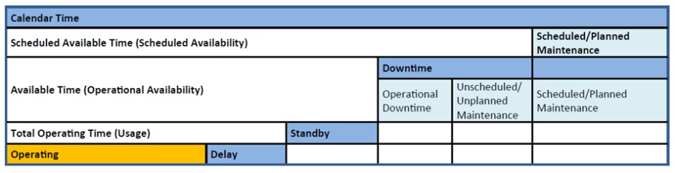

The way mining companies measure the performance of their equipment fleets today varies from company to company, but most use a Time Allocation Model or TAM.
Under this model, mining engineers gather data related to equipment hours using paper log sheets or a Fleet Management System. They then allocate that data to measurement groups – usually Operating, Delay, Standby, Downtime, Planned Maintenance and Unplanned Maintenance – that, added together, equal total Calendar Time. The engineers then use these measures in various formulas to create KPIs, such as availability and utilization.
TAM remains a manual process at many mines, where engineers type numbers into a spreadsheet and create a chart like the one below:
However, charts like these do not promote detailed analysis or make it easy to compare current results with historical performance.
