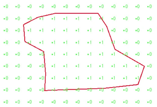

Hey everyone,
Today's bite size piece of code is all about determining whether points fall inside a boundary or not. Why you might ask? Well sometimes you just need to modify a selection of points in a layer and a boundary string is a great way to do this.
This code snippet assumes you have point data and a boundary string in the current active layer.

The final result will be something like below.  Hopefully this sparks your imagination for other things you can do with this code.  If you need a hand implementing it or have any questions, please leave a comment below.
