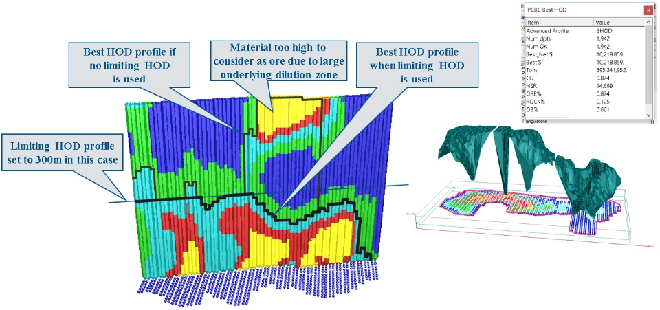

The height of each draw column is critical in determining the viability of the operations over the life of the mine. The draw column height represents the economic height of diluted ore that can be drawn from that extraction level under the defined capital costs and profit conditions, according to Sandra’s Cave Mining Handbook. “There is no room for the philosophy that ‘we’ll maybe it will work.’”
In determining BHOD, the draw column height represents the total minable mineral reserves in that column. The ore will become diluted with other waste material toward the top of the column near the surface. Generally, the higher the draw column, the lower the dilution will be, assuming that the ore/dilution interface is maintained as a distinct zone and dilution only enters the column at the height of the interaction zone. The BHOD production level is calculated to that level before waste material begins mixing with the minable ore. This height is used as an input in the production schedule in the next steps. BHOD calculation can be done in PCBC by defining economic parameters and geotechnical constraints. The available visualization tools can significantly save engineers’ time for making critical decisions in this step.
In some cases, coarse fragmentation creates a “contact zone” rather than a distinct line, which affects the calculation of dilution, along with other factors such as excavation stability and the geometry of the draw zone. The non-ore material, however, has a life of its own we call “flow” that also must be factored in an optimized production schedule.
Calculated BHOD using PCBC
