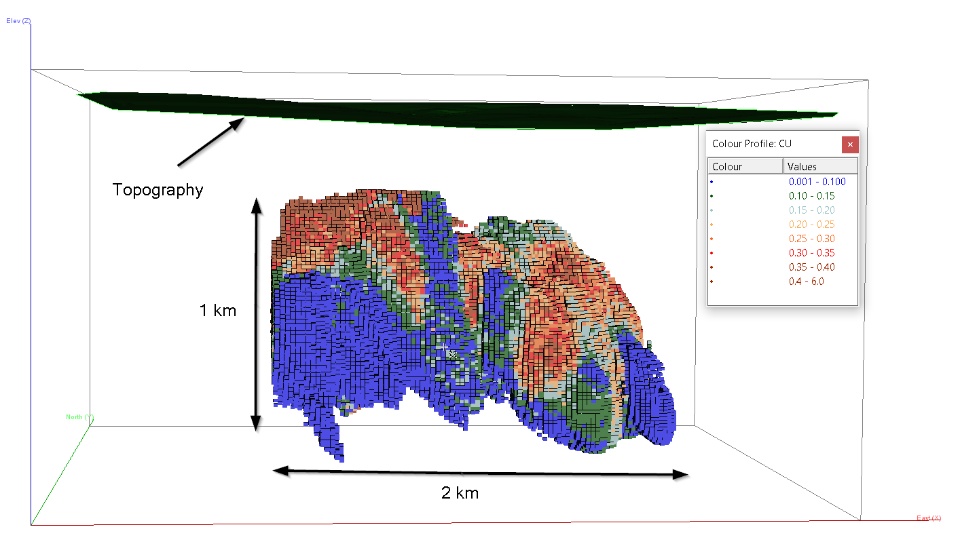

The goal is to end up with a 3D block model containing all the characteristics and attributes of an orebody and associated waste located in a potential mine area. This model becomes 4D when time comes in during the production schedule stage.

Block model
Orebody dimensions, inclination, cavability, fragmentation, size of the caved material, and the mine site location will influence how engineers will configure draw patterns, draw point or draw zone spacing, layout design, undercutting sequence, and support system design.

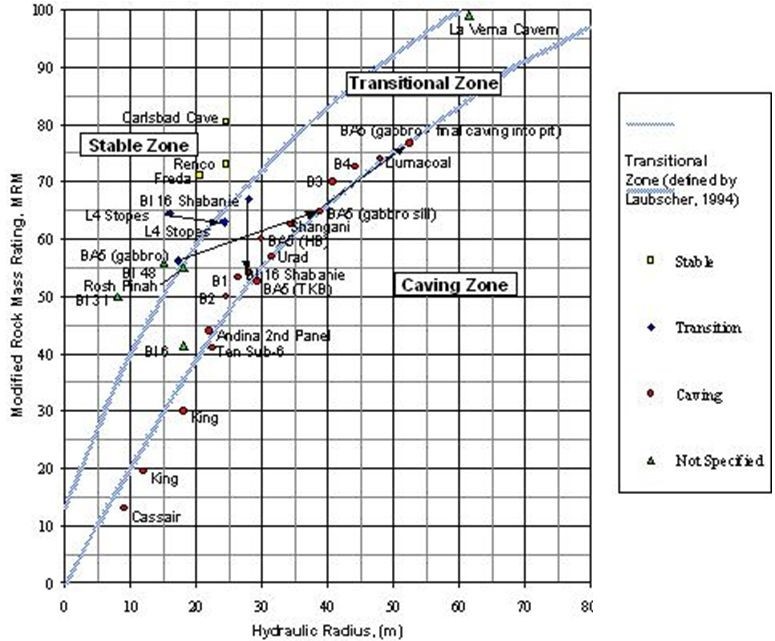

There are some guidelines to start with, such as the SME Mining Engineering Handbook and Laubscher Manual on Block Caving. Lessons from successful caving projects and implementing knowledge of experienced caving engineers can provide measures to analyze the project.
Stability diagram (Laubscher, 2000)
