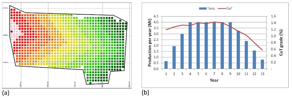

Footprint Optimizer then takes the extraction for every level to simulate a production schedule using additional inputs, such as mining sequence (Figure 2a), production rate, numbers of new draw points, and extraction rates. From that schedule, it forecasts evaluation, tonnage, and grade by year (Figure 2b), and estimates the economic value of that level by considering the discount rate and (optionally) a capital cost.
Figure 2: Production schedule in Footprint Optimizer: (a) mine sequence, (b) tonnage and grade.

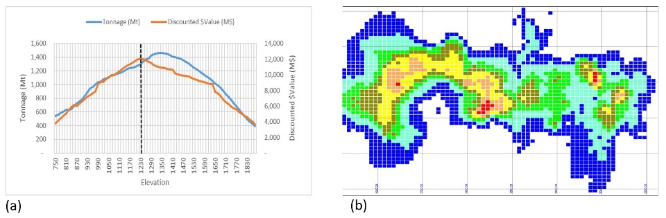

After every level is evaluated economically, Footprint Optimizer summarises the results in various ways. Figure 3a, for example, compares tonnage and discounted cash flow, while Figure 3b displays the economic value by level and block.
Figure 3: Results from the Footprint Optimizer: (a) footprint size and (b) value distribution.

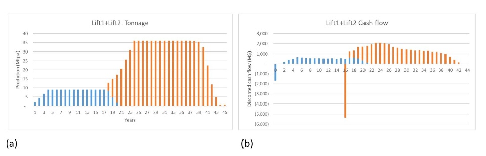

  • Footprint Optimizer then took the extraction for every level to first simulate a production schedule that assumed Lift 2 production would start as soon as the Lift 1 ramp-down started, and then forecast evaluation, tonnage, and grade by year for Lift 1 and Lift 2 in combination.
  • From there, Isight automatically calculated the cash flow per period and allocated capital cost at the beginning of each lift using a Python code that allowed us to explore different scenarios and apply different rules (see Figure 8). For example, we could:
    • control the time for Lift 2 starts by an offset depending on the production target used by Lift 1, and
    • apply a delay in production to replicate the additional development required to produce the first ore if the footprint analysed is located in deeper conditions — an option that helps associate the level location with the economic value calculated using NPV and IRR for each scenario simulated.
Figure 7: Option 3 Lift 1 and Lift 2: (a) production rate and (b) cash flow calculation.
