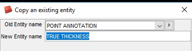

Plotting > Entity > Copy. Call it “True Thickness”

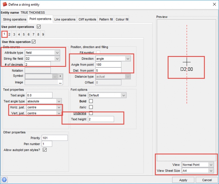

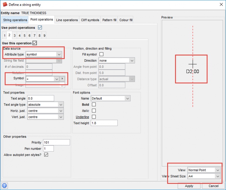

Plotting > Entity > Edit.
Enter in the name of the entity you have just created.
Fill in the forms as follows. This will display the thickness at the bottom of the symbol.

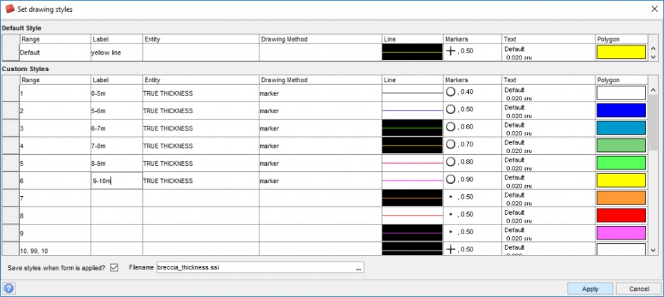

Customise > Display Properties > strings and points.
The styles file that is used for the breccia thickness will be displayed
Step 5:
Assign the entity we have created to each of the strings and save the grade styles file. An entity has a higher priority over the plotting styles than the display type.

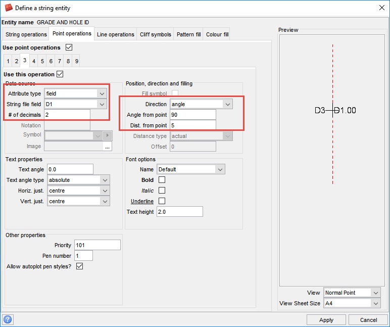

Repeat step 1 and create an entity called Grade and Hole ID
Step 7:

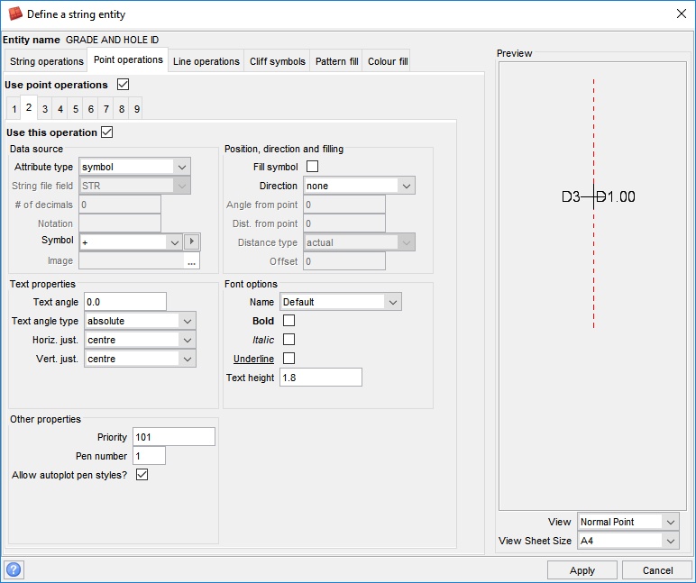

Plotting>Entity>Edit. Enter in the name of the entity you have just created.
This will display the grade on the left hand side of the symbol and the hole ID on the right hand side.

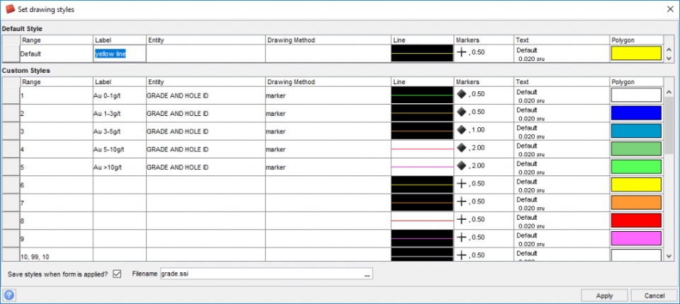

The styles file that is used for the breccia grade will be displayed
Step 10:

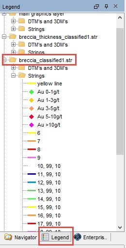

There are 2 ways to set up the legend. Either through Autoplot or by inserting an image. In this exercise we will insert an image into the plot.
Step 14:
While the string file is open, take a screen grab of the 2 styles files from the legend tab and save.

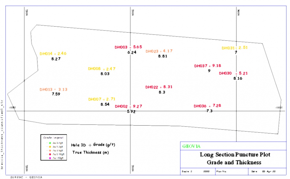

Open up the plot, create > image.. and drag the size of the legend box.
Select the image file and apply.
Using the create tools in the plotting window, create a legend for the symbol.
